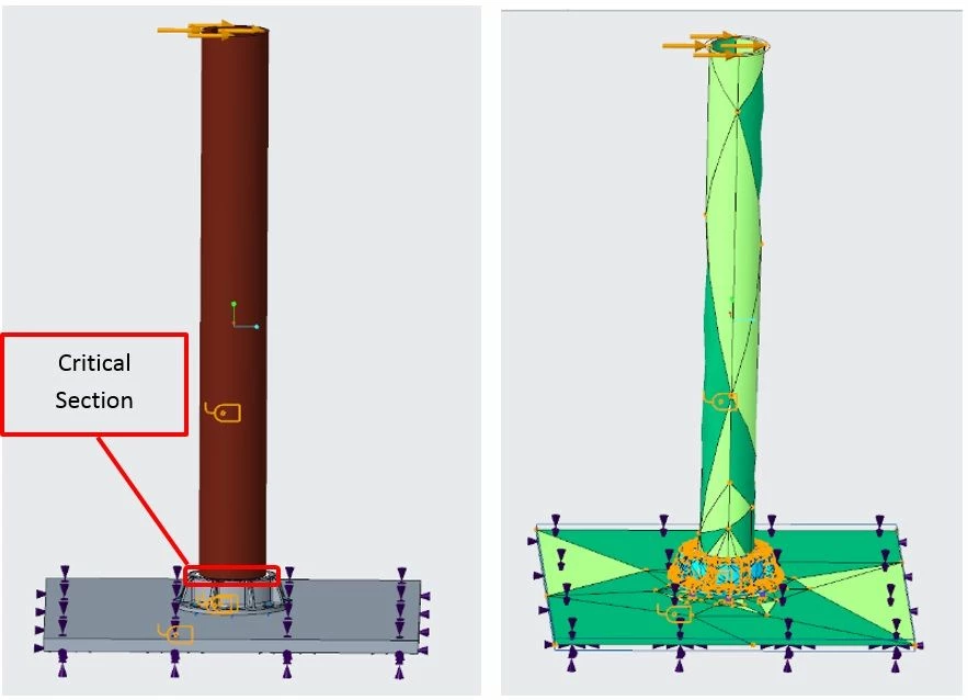

Using a mechanical testing machine I have determined that the bending strength of a hollow circular shaft with brittle material to be about 18 KN at the height of 1.47m. The force was applied perpendicular to the shaft axis at the top end. The attached image shows the simulation setup similar to the real test.
ID and OD of the cross section of the shaft are 0.13m and 0.18 respectively. The breaking stress due to bending has been calculated (momentum/section modulus) as 63 MPa at the critical section where it gets constraint . I have been using this value to compare the results from simulations.
Simulating this bending test in Creo, I find quite different results:
1- Using solid body mesh, the stress is about (Max Principal) 150 MPa at the critical section
2- Simulation Live in Creo Parametric shows Max Principal to be 82 MPa
2- Using mid-surface shell, the max principal is about 108 MPa at the critical section
3- When using shell it is possible to exclude membrane and shear, so the stress due to bending becomes 54 MPa

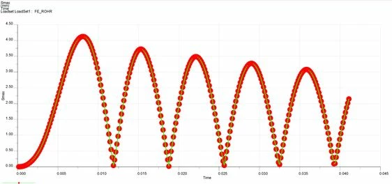

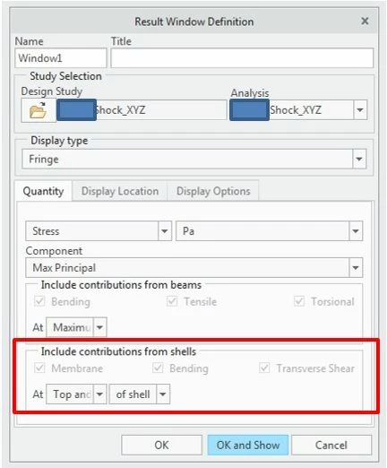

3- We use the component in a structure that should be tested against shock after finding mode shapes. Surprisingly, when using shell elements it is not possible to exclude membrane after performing the shock study. Is this a software limitation?
A screenshot of the results configuration window for a shock study is attached.

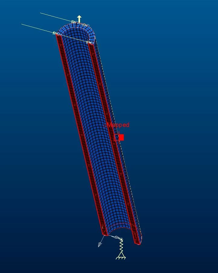

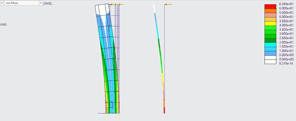

Thank you for so much for your comments and providing the example model. I reviewed the model and run it; the result is quite close. I have tried mapped meshing on the entire shaft (not mirrored) but again no success in getting close to the expected result. I am reluctant to use mirror symmetry constraint because the shaft will be used in a larger non-symmetrical assembly where forces from all directions will be acting on the components (a shock study with accelerations on x, y, and z axes, and a static study with forces on x, y, and z directions).

"... I use structural bolts to mount the bottom component to a plate (acting as ground). ..." not relevant
please observe measures!
3D-example att.
