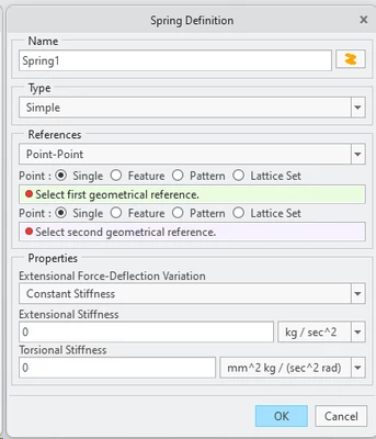

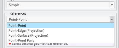

The usage of "to ground" springs is not supported in non linear analysis but linear one is permitted. So I want better understand the main difference between them.
SIMPLE
You can write a function to establish the relation F=k*x.
Only one constant for linear and rotation movements; so if I want the point forced not only in 1 direction, I must lay other springs.
It required two "supports", two ends that gonna be linked with spring.

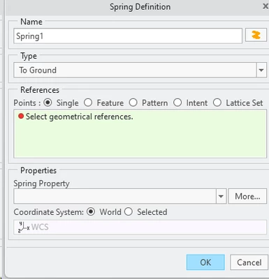

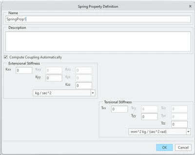

TO GROUND
You can write a matrix with different direction constants.
Only one side of "ends" to specify because the first is obviously the ground and it's not required its specification.

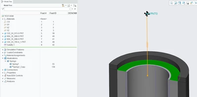

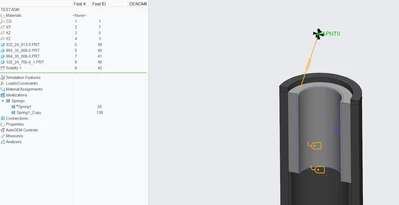

QUESTION: Large Displacements Analysis --> why the solver give me an error if I want to replicate a ground sping with a simple spring linked with point and surface?
The first one, the "like ground one", is a point external of the geometry where I've putted a fix constraint (so the ground).
gfraulini_4-1739006620040.png OK
gfraulini_5-1739006701528.pngNOK
To conclude the post, I ask for an explanation to better understand the use of spring with LDA.
