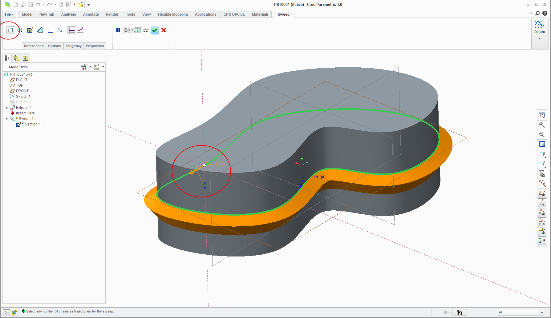

Has anyone tried to create a swept protrusion in Creo 1.0. In Pro/E 5.0 you could select Sweep, Protrusion then sketch a closed trajectory. Once you create the trajectory you could use a open sketch and add inner faces to create a solid. I am unable to find the same function in Creo 1.0. Any help would be appreciated.

Hi Brent, Sweeping open sketch around a closed trajectory works fine. Creo warns you that if you use open sketch he will convert sweep into surface one. If it intersects with solid it can be solid sweep with open sketch.
October 23, 2011
Hi Davor,
I know it works the way you describe it, but ...
in WildFire 5 and before you had the option "Add Inner Face" which would allow you to create a solid by using a sweep with a closed trajectory and an open section.

You are correct, this feature is missing. I have logged the case with PTC and the have confirmed that the feature is missing. I created a part in WF 5.0 and then opened it in Creo 1.0, I was able to edit it and all the options are there but not to create the feature from scratch.

Just an update, PTC took the functionallity out and is not going to put it back. Below is what was stated:
These capabilities were removed because of combination of sweep and variable section sweep. These options only work in a very limited number of geometric cases. Those cases are covered by using the Fill surface command. As such it was chosen to remove them and the user can then build a more robust model using fill surface.
There is no intention at this stage to add these capabilities back.

It's clear to me that PTC effort to improve has caused problems. I would ask that PTC should show the alternate method that they are describing in their solution. From my standpoint changing this feature has impacted many users that I have talked to and in fact the trainers in my local reseller have no alternate method that they can teach. So if there is a better way to build a more robust model as PTC describes it please show us and let's us evaluate.
Brent Meyer
April 12, 2012
I agree completely with the other people here.
If I have understood everything correctly the solution is to create the sweep as a surface, create two fill surfaces, do a merge to create one big surface and do a solidify to create the solid.
This is a very cumbersome way to circumvent the problem compared with how it could be done in the past.
I can understand why PTC has omitted this feature as they now present both regular sweep and variable section sweep in one interface. But I don't understand why this should be confusing for users. It can't be that difficult to disable the variable section sweep button when a closed trajectory and an open section is used.

I found perfect and easy solution for Sweep feature with Add Inn Faces function for Creo Parametric 1.0 and Creo Parametric 2.0 - it is does not exist, but you can do it.
I'll create video tutorial and I'll let the post on video link here
