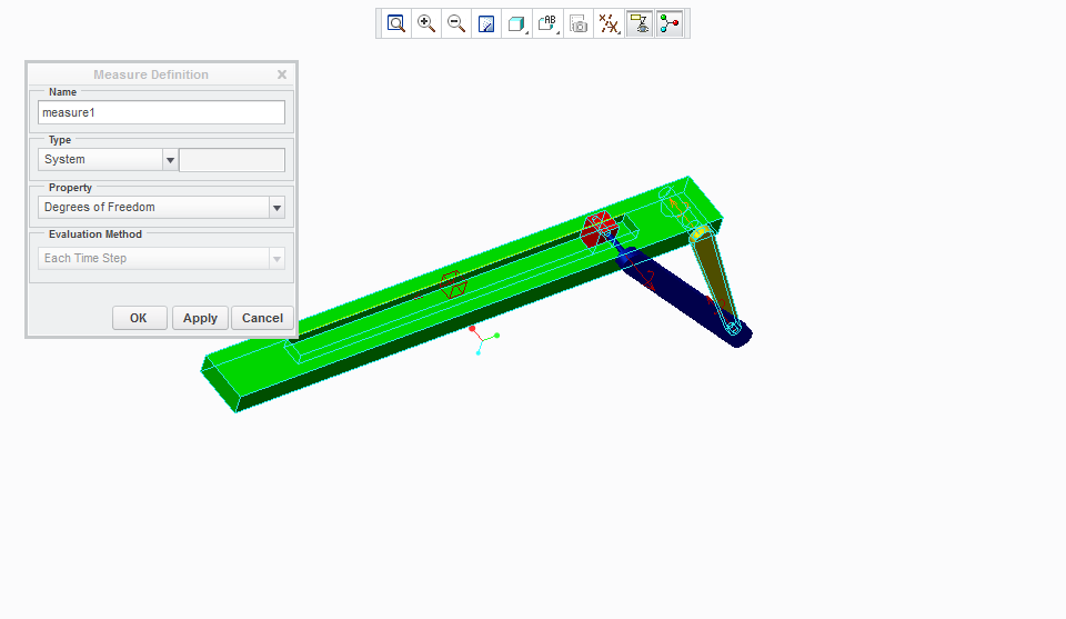

The degree of freedom
anyone can help me
I do not know what wrong
I know this law of degree of freedom
n = 3 (l – 1) – 2 j – h
l=link , j=lower pair , h=high pair
n = 3 (4 – 1) – 2 × 4– 0 = 1 one degree of freedom

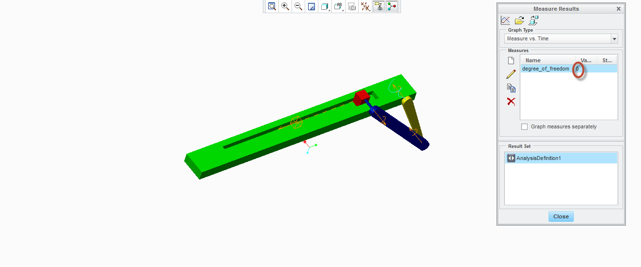

but of program I think this happen
n = 3 (4 – 1) – 2 × 4– 1 = 0
n = 3 (4 – 1) – 2 × 4– 0 = 1 degree of freedom
n = 3 (4 – 1) – 2 × 4– 1 = 0 but this result of program

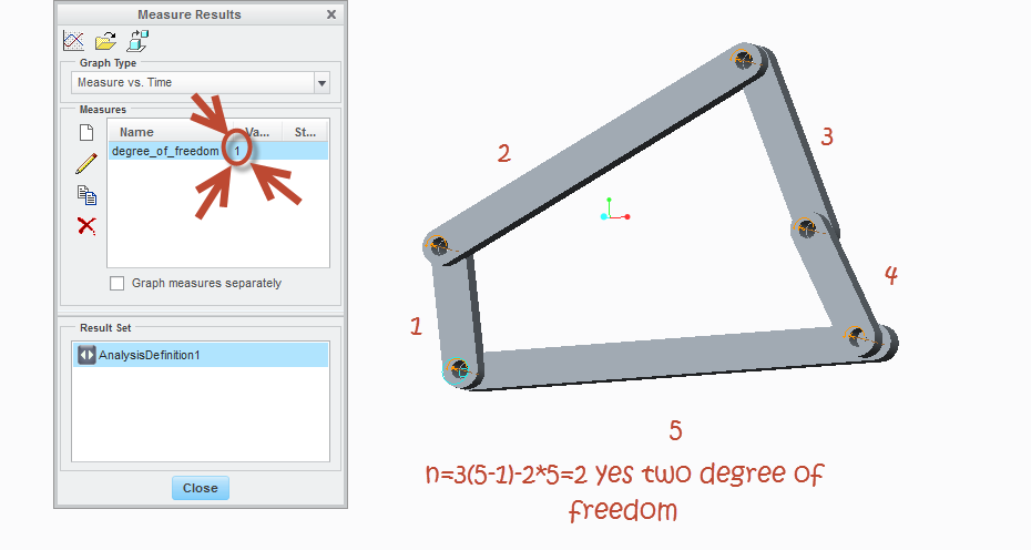

this example of 5 link i must have two degree but program give 1 degree

Each motor controls a degree of freedom.

https://en.wikipedia.org/wiki/Chebychev%E2%80%93Gr%C3%BCbler%E2%80%93Kutzbach_criterion
The formula for the planar condition in the link above, appears different from the one you show.
I agree, the depicted mechanism looks to have 2-degees of freedom. Check to make sure none of the pin joints has an extra constraint.
jwaller1-VisitorAuthor
August 18, 2014
I give my formula form book "Theory Of Machine R.S.Khurmi"
and this not problem
problem is all my mechanism degree of freedom have less than one
I check pin from all bar and I think no any extra constrain but same result all time

Have you attached any motors?
