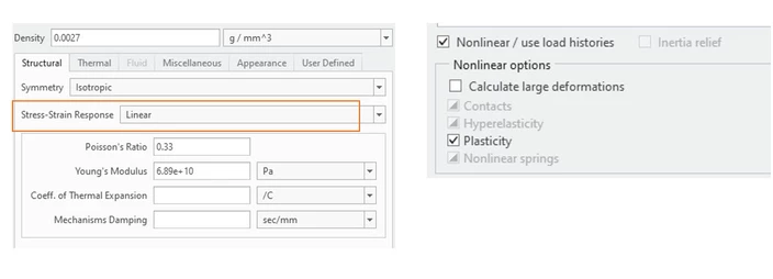

When the stress-strain response of the material is defined as "Linear"; under what conditions one must activate the "plasticity" for the simulation.
Static simulations with linear material responses are considered "small deformation" theory.
If plasticity or large deformation does not exist when using linear material responses, why not black out this function.

Is this case done by using the "Elastoplastic" in the "Stress-strain response" definition of the material settings?

In Creo Simulate, when we perform a simulation where the maximum stress exceeds the yield point. In this case, we will apply "Elastoplastic" to the stress-strain response of the material definition. At the same time, "Large deformation" and "Plasticity" in the nonlinear options are automatically checked. With this setup, we may get a result that is close to the real world situation.

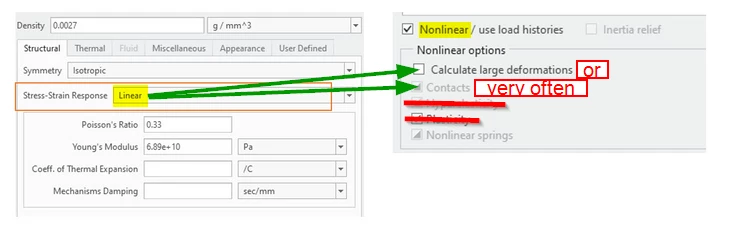

Conversely, in a linear material circumstance, the "nonlinear option" in the Analysis Definition is still available. Therefore, I was wondering what kind of situation would use the nonlinear options. If not, why not to block these functionlity.
skunks
Jun 10, 2022 9:37 AM UTC
  • a linear material and large deformations (often)
  • a linear material and contacts (very often)
