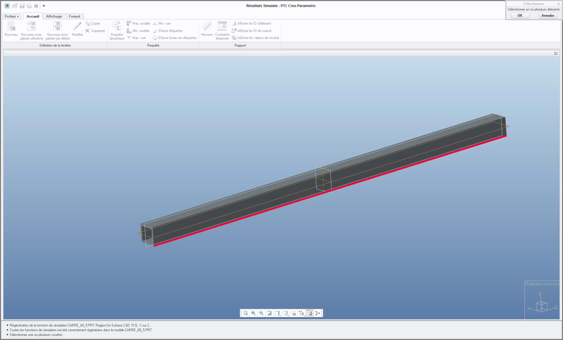

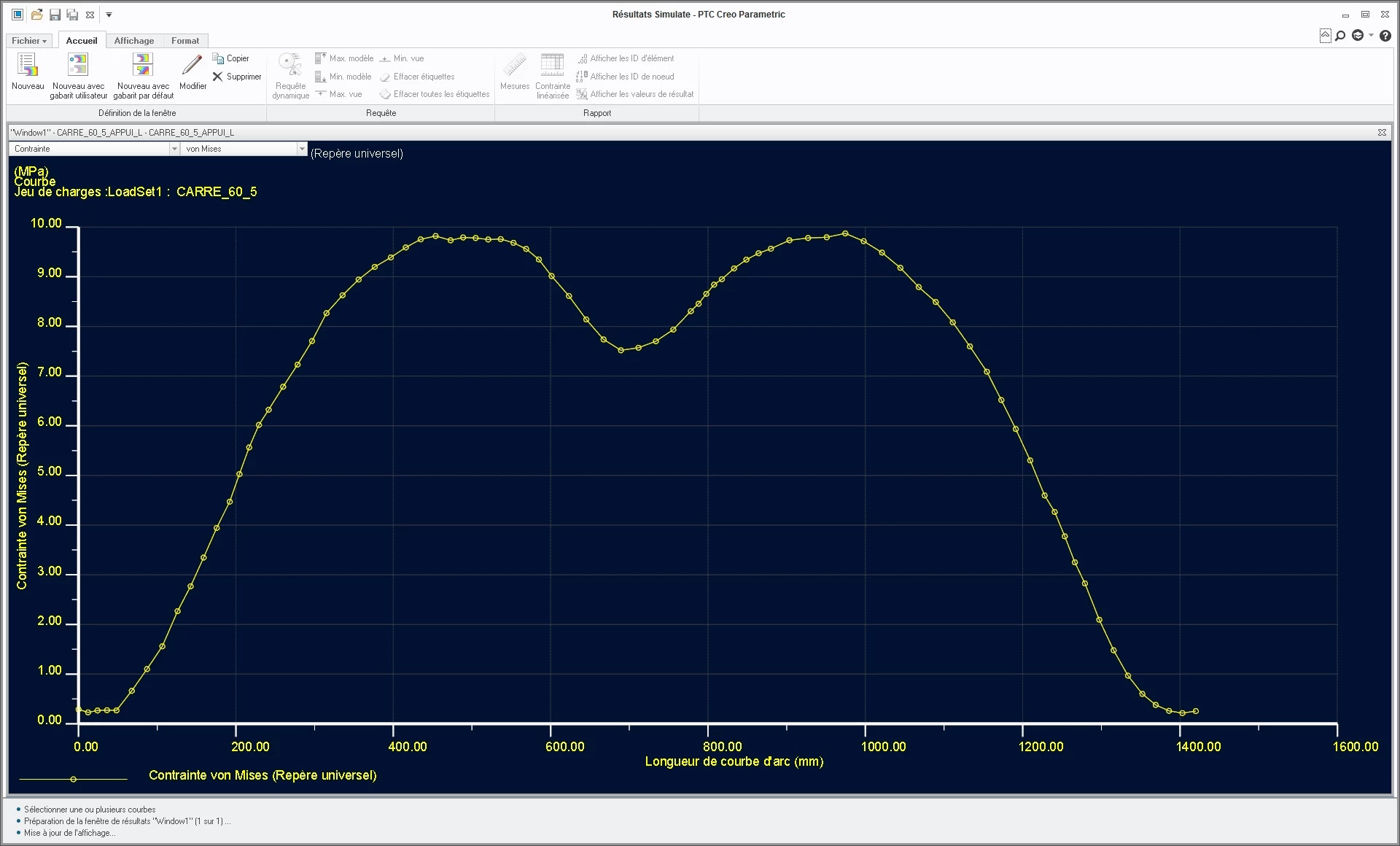

    April 18, 2017
    Hello
    To complete my question I have attached two images for the tube square with the
    making a stop to trace the curve.

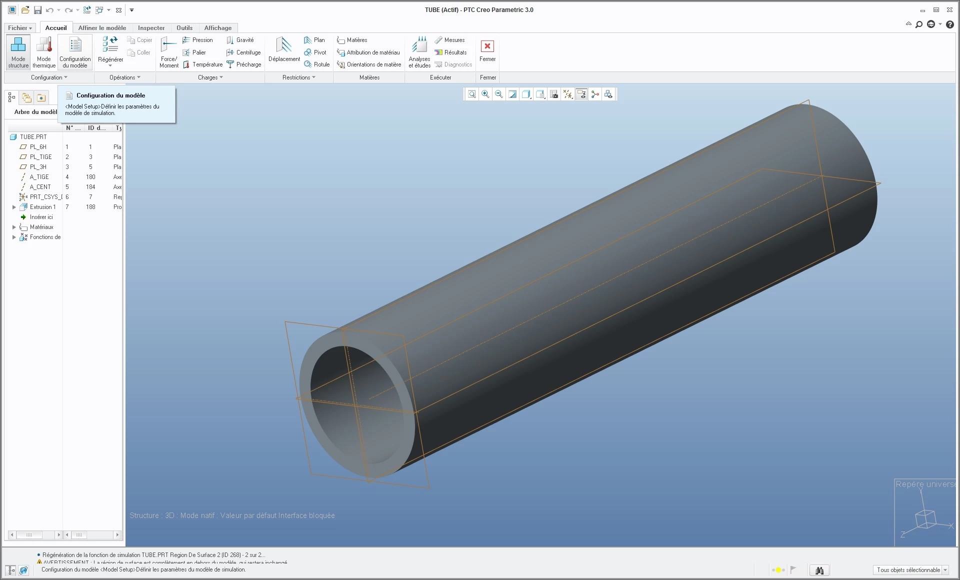

    And a picture for the cylindrical tube, how can we take one stop
    on a cylinder or what is the way to get the same result.
    Kind regards.
    Denis
    April 18, 2017
    I'm not completely sure I've understood your question correctly, but could you use a surface region to create suitable edges?
    April 18, 2017
    The cylinder is smooth I don't have to stop, to be able to trace the
    curved, it is requested a stop
    April 18, 2017
    You can try by putting a hard point where you want to stop it.
