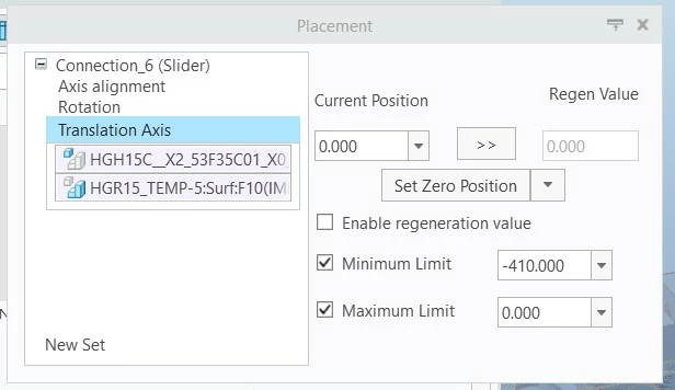

I'm working on my first mechanism and I'm facing some issues.

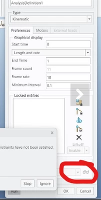

I set up all the servomotors and set a sequence for a position analysis, but all the motors move together in a while.
So, I wanted to set a velocity profile but when I start the analysis I get errors and cannot perform it.
I checked some videos and I guess I have to define the dynamic properties, but in the slider connection /translation the box isn't visible.
I'm using Creo 9.0.5.

The problem is your analysis is forcing the position outside of the travel limits.
at 600 mm/s you will reach 410mm in 0.683333 seconds, but you ask to go for 1 second with only 10 frames.(0.1s,0.2s,0.3s...)
At 0.6 seconds a frame is made and the travel is 0.6*600 = 360mm. At 0.7*600 = 420 mm >410mm so an error and only the previous frame at 0.6s was successful. If you did 100 frames the last success would be at 0.68 seconds =408mm.

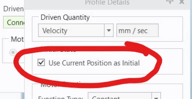

Current Position as Initial means wherever you last left the model.
It is better to set your analysis with an initial condition that starts with a snapshot with the configuration at the true beginning. (circled, looks blank to me)
Another way is to control the position rather than the velocity. This way the initial position/condition does not matter and can be left blank.
I would use driven quantity position and function type table and have two lines like so.

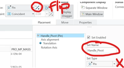

I would try to change the direction so it travels positive 410 rather than negative. There is a flip direction for the initial connection definition. The slider arrow points in the positive direction and can be flipped. Also in that definition there is a place to change the joint names so they are more readable rather than "Connection_6" In my example "Handle_Pivot"
