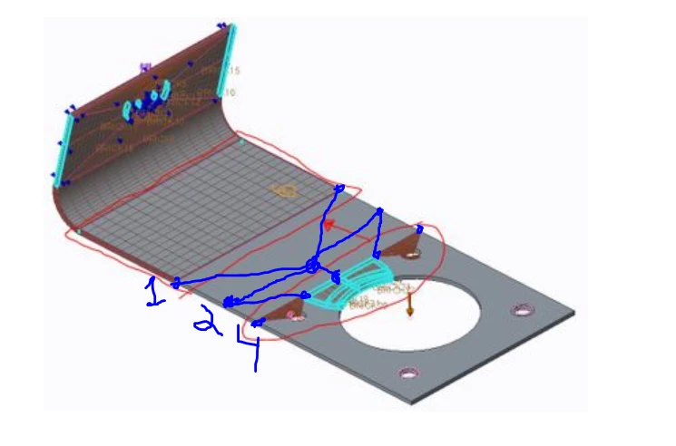

Just having a play around with the advanced simulate and attempting to create a fully mapped mesh.
As I have some holes in the surface (see very bottom), I am having to do some jiggery pokery to transition from the highlighted area to a nice, uniform, brick mesh but I have come across an issue that doesn't allow me to create certain volume regions such as this:
So I am wondering, am I missing some criteria that means I cannot create volumes in certain locations?
Cheers,
Nick
Best answer by SweetPeasHub
The volume regions cannot have a single face on one side and multiple on the other.  There are 4 segments on one side and 1 on the other.  You have two choices.  1. Propagate 4 segments through entire model.  2. generate a transition from 4 to 1 segment.  This image shows option 1.
And this one shows option 2.  Option 2 requires some wedge elements to generate the transition whereas only bricks are needed for Option 1.
On the other hand I prefer not to use volume regions but rather datum points to define the regions.
These images show how I use sketches and datum points to generate the mapped mesh.  It is a little more tedious because of picking 8 points instead of 2 faces as well as the initial generation of the points is more tedious.  I have had better success mapping this way.
There sill might be some further refinement needed as far as element sizes and smoother transitions.
regards,

Can I just start by saying... Wow! That is a thing of beauty!
I had a go with the datum point method with some success but I think I'll start this again, as currently it looks a complete horror show in comparison!
Thank you for your help.
