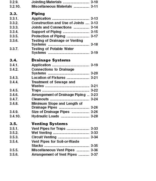

Hi again,
I searched and didn't find an answer.... How do you get a title to wrap nicely before the page number when you have a very long title?
I haven't tried it yet, but might an alignment group work? This also might be a "problem" in the index when you have term wrapping.
Has anyone else solved this problem before?

    Can you give us a little more detail about exactly how you want the
    title to wrap and be aligned? What isn't working about the approach
    you're using now?

    It should be possible to accomplish what you want with just indent
    settings and maybe some indent items in the appropriate savetexts
    and/or usetexts.

    If you want both the title and the page number to be on the same line, you would have to use algroup. Otherwise, assuming that the title occurs first, putting a right-indent on the title would make the title and the page number render on separate lines.
    You can't do much horizontal formatting (indent, justification) unless you also have block formatting.
    February 26, 2010
    Algroup is usually the best solution.
    It is possible to build a table by inserting table markup directly in your construction rules. If you have to use dot leaders on your TOCs, this can cause different problems, but for very simple tables, this usually works pretty well.

    Here's an example that might help, see the attached file for how it looks when composed.
    In the <title> e-i-c, the savetext is:
    <savetext textid="toc-part.app"&lt;br"/>conrule="<toc-subsect.fmt>, ssecnum, @56pt, #CONTENT, 0.34em, dotfill, 0.34em, subsect-pg-numb.txt, -33pt, </toc-subsect.fmt>"
    append="1">
    The character fill for 'dotfill' is:
    <charfill literal="." cfid="dotfill" mincount="2">
    The formatting pseudo-element is:
    <e-i-c gi="toc-subsect.fmt&lt;br"/> <charlist charsubsetref="title-bold-9">
    <indent leftind="68pt" rightind="*+136pt" firstln="*-56pt">
    <quadding quad="left" lastquad="ljustify">
    <postsp minimum="1.2pt" nominal="1.2pt" maximum="1.2pt">
    <keeps scope="col" keep="1" next="0" prev="0">
    </charlist>
    </e-i-c>
    You'll need to adjust spacings to suit your page. Hope this gets you started.

    Thanks this was exact type of example I was thinking about.
