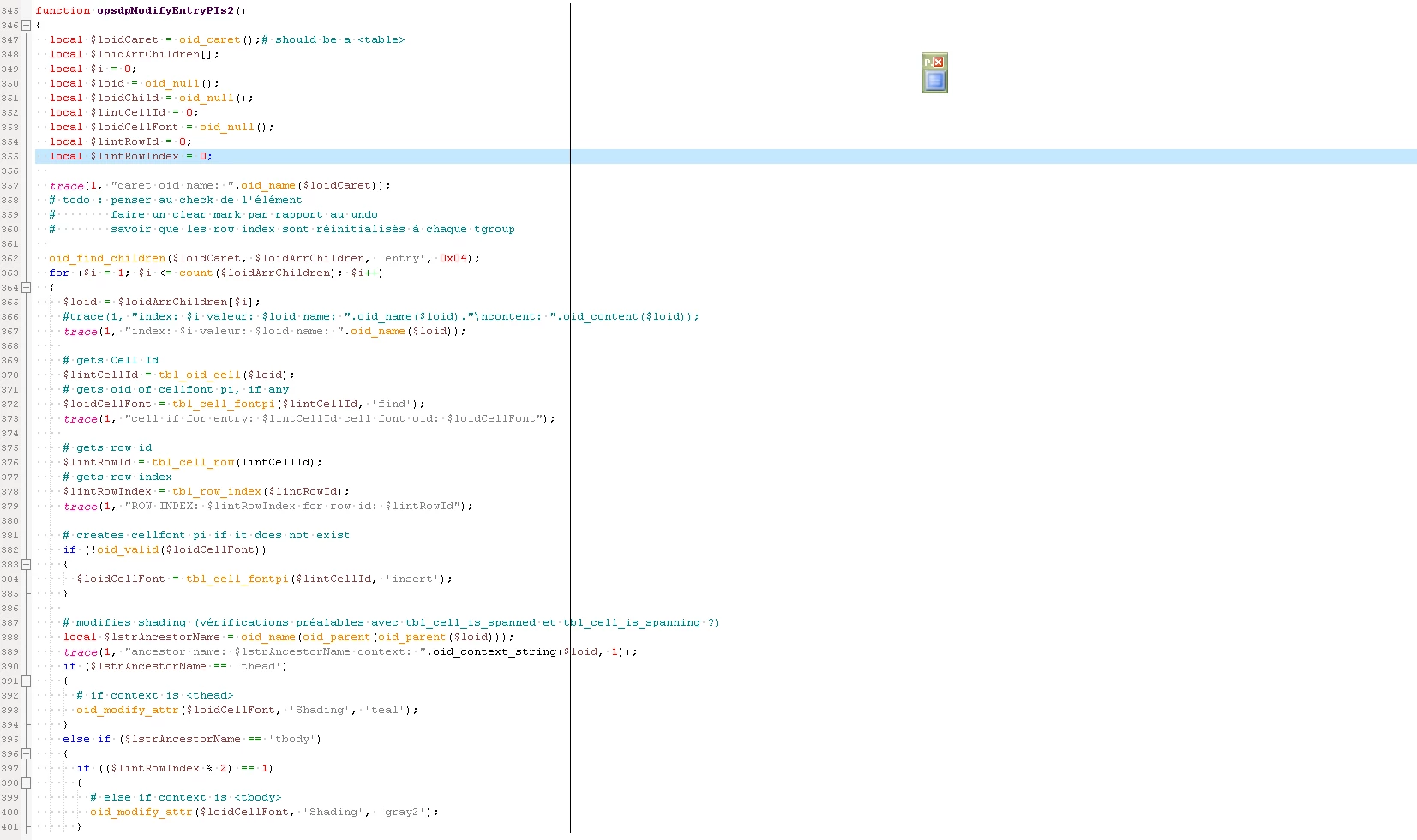

    I use Ultra Edit. It is not very expansive, and allows to manage a specific syntax colouration.
    Here is an example :
    Sébastien
    Le 26/10/2011 18:40, Clay Helberg a écrit:Hi Mike (and anyone else who's interested)-- I posted a copy of my jEdit ACL tools on the adepters.org wiki. You can find the download link on the "Developer Utilities" page (
