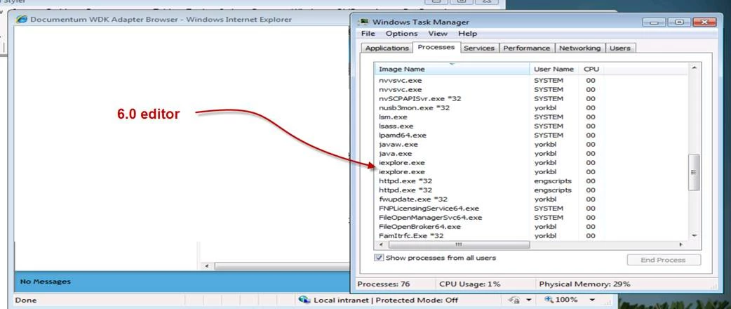

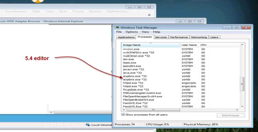

    So I went back to double check myself. Turns out that fixed the 5.4 version on that machine but not the 6.0 version on the machine. So I what I found out 6.0 is using the 64bit version of the browser because I installed the 64bit version of editor. I bet if you were to install the 64bit version of Java or the 32bit version of editor it would probably work.

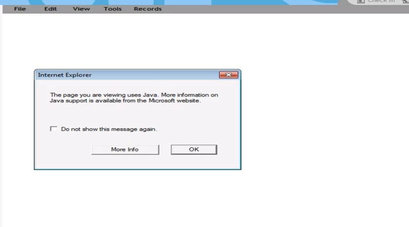

    Here is one more confirmation. This is the error I get in the x64bit version of IE.
