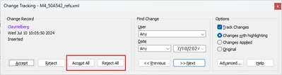

If you are talking about standard Arbortext Editor change tracking, you can use the Accept/Reject Changes feature to clear them all at once (either reject all changes or accept all):
If you are using an S1000D implementation (which is indicated by your use of "DM" instead of "document" or "topic"), then you will probably need to check with the vendor of your S1000D solution. They may have some custom scripting to let you clear the changemark attributes in your document, or you may have a publishing option to hide the changebars in the output without modifying the markup. But that would depend on the specific S1000D implementation.
