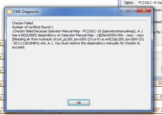

    Jun 22, 2012 2:07 PM UTC
    Alessio,
    Thanks for the tip. I tried that, and it didn't work. Not your fault, I checked the lang attributes in the xml book, and noticed there was 1 that was an undeclared .psu file for british. I reverted the profile back to the original (I translated it from japanese), and that error stopped popping up (the undeclared element is still there, but it can't understand the profiling so I don't think it's trying to anymore).
    However, since this book is a zipped book from the parent company's windchill, the files are still saying they are dependent on each others revision levelsto upload (Since some pulled from different books). Here is an example below. How do I prevent the books from carrying this, since for my new database they would all be A.1 anyway? The error comes back with a different referenced file every time, I assume because they are all dependent.
    Also, would my windchill have a problem if the master language defined in wc is english, and the master language of the xml files was japanese (translated to english as xml:lang=en)?
