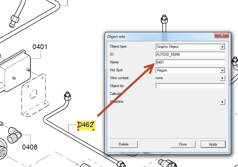

Doing manual edits on a 4 digit text number. Need macro for IsoDraw to match manual text edit
Doing manual edits on a 4 digit text number but noticed when I call up the Object info that the name shows the previous text. For example change a text 0401 to 0462. When I do a Object info it still shows 0401 in the name (see attachment). So I want to develop a macro that will change the object info name to match the manual edit. In this case 0462. Here's the macro code I have so far:
Here's the code:
Macro change_name_in_object_info
Define el as Element
Define Text as String
Define output as String
Define text1 as string
el=ActiveDoc.FirstSelectedElement
Select if Type is "Text"
        WHILE (Exists (el) = true)
text1=Text
el.info.name = text1
el = el.nextSelectedElement
        End While
select none
End Macro

Main issue was you were doing your select after assigning value to el. Try this.
    Define Temp as string
    el = ActiveDoc.FirstSelectedElement
    While (Exists(el) = true)
        Temp = el.text.string
        el.Info.Name = Temp
        el = el.NextSelectedElement
    End While
    Select None
End Macro

Nov 30, 2016 6:48 PM UTC
Trevor the code you posted worked like a charm. Great as always! Thank you for helping out.
