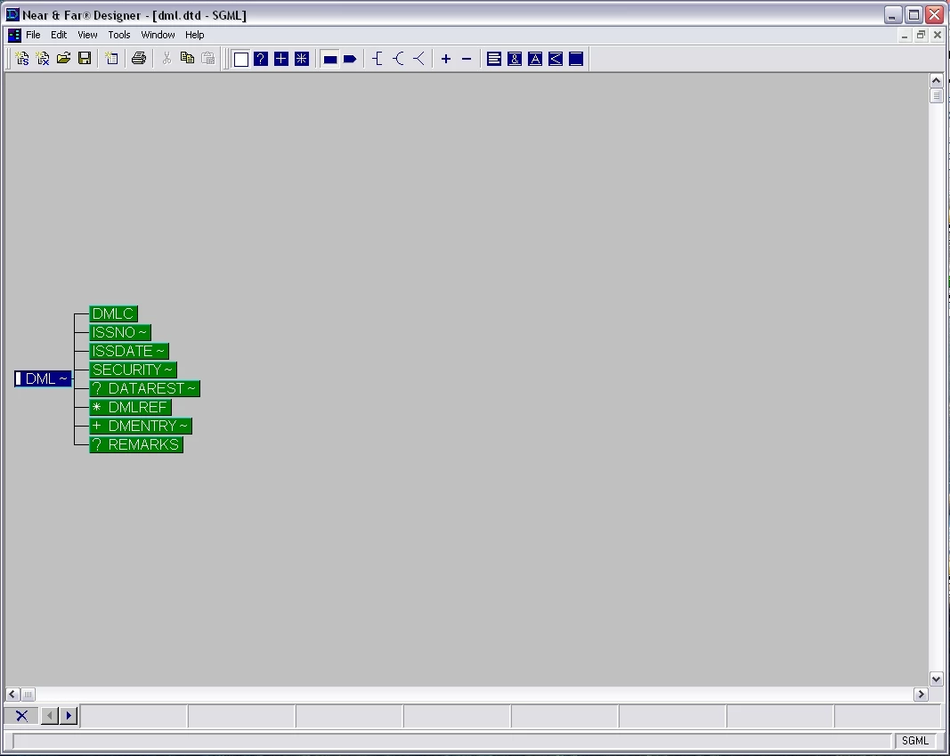

    Apr 19, 2011 11:48 AM UTC
    Hi Steve,
    If you can find a copy of Microstar Software Ltd. "Near & Far® Designer" which was an application from 1993-1998 it will "flatten" a DTD in the manner you suggest. It works with SGML and XML. However, it's getting old. I've included a picture of an S1000D issue 3 SGML DTD for your reference so you can see what it looks like. I had to point out to Near & Far Designer where the catalog was before it would open it. If you "save as" you can save a DTD to another location and it appears to flatten the file in the manner you are looking for, i.e. all the notations etc. would be included.
    The primary purpose of this software was to create and edit DTDs.
    I've also manually looked into a DTD and manually copied all the external notations etc. into it, which is a long but rewarding process if you have the patience to see it through.
    Greg
    Apr 19, 2011 2:05 PM UTC
    Greg (and Dan),
    Thanks for the suggestion. Would like to try it, but could only find sites that reference other download locations (Google and Yahoo searches). Doesn't appear to be available anywhere, now.
    Did find a few, very old forum threads that discussed it, but again, nothing in the way of a copy, even for testing purposes.
