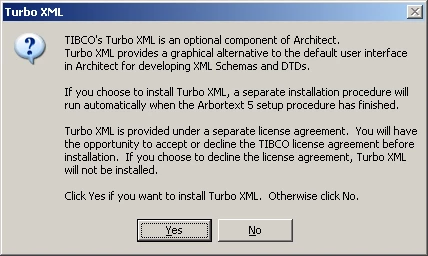

    So we finally got clearance to do a test install of Turbo XML. Good that far.
    Someone on here said they had to point it to the entity locations. I'm sure that was 'intuitive' for them, since the documentation and reviews all seem to describe it that way, but it hasn't fit my intuition yet.
    Or maybe I misunderstood.
    In any case, having difficulty getting it to see the location of the files referenced by our parameter entities. We're using entries that depend on the public ids being found using a catalog. Doesn't look like that's acceptable, but also haven't found where to give it the path to our 'DTDents' folder.
