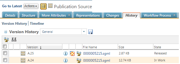

Dear all,
Sorry the dummy question, but how to open/retrieve a old file in the version history tab?
I would like to open into Arbortext the version "A.24", but when I click over the "Actions" button, it does
not give the option for previous iteractions. Any workaround to get the old file?
Thanks in advance the community!
