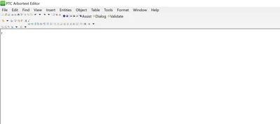

Small toolbar icons on laptop
On PTC Arbortext Editor, I have small toolbar icons that are to hard to read when i work from home on my laptop.
Anyone know how to make them proportional to the screen I am working on?

I'm not sure that Arbortext itself has a scaling option for the window UI elements. However, you can force Windows itself to scale up all the windows (including Arbortext). If you head to Display settings in Windows 10 or 11 you will find a "Scale" option which is set by percentage. You could try 150% or 200% to see if that helps?

Thanks, I am at 400% now, ridiculously large, but the icons are normal. Much appreciated.
