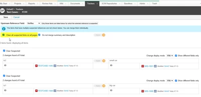

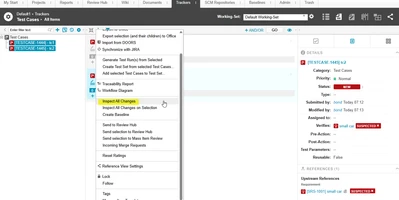

Then in Test Case tracker I used the "Inspect All Changes" menu.
Did not apply any of the changes, but checked in the "Clear all suspected links in all pages" check box.
Then clicked on the Save button.
As a result of this, the suspected badge became gray.

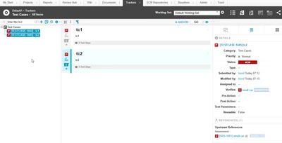

I did the following small test.
I created two items in System Requirement Specifications tracker, and two items in Test Case tracker.
I added items from SRS into Verifies field of Test Case tracker items, then did one change in SRS items.
As a result of those changes, suspected badge became red.
