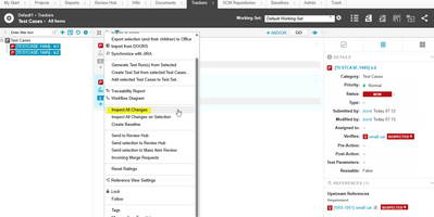

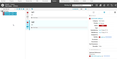

We have suspected flags/links to Test Sets and whenever there is a change in any system requirement it triggers a suspected flag (red color) shown below.
This kind of "Suspected flags" are visible in other test sets as well. We want to clear all the Suspected flags in one go with bulk/mass edit. Is there any possible way to do it?

I created two items in System Requirement Specifications tracker, and two items in Test Case tracker.
I added items from SRS into Verifies field of Test Case tracker items, then did one change in SRS items.
As a result of those changes, suspected badge became red.

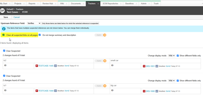

Then in Test Case tracker I used the "Inspect All Changes" menu.
Did not apply any of the changes, but checked in the "Clear all suspected links in all pages" check box.
Then clicked on the Save button.
As a result of this, the suspected badge became gray.
