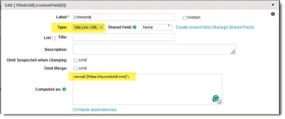

 We have integrated Codebeamer with Windchill PDMLink via OSLC and ThingWorx Flow. We created a custom field ,called[ Windchill ] to add the Windchill Link to the properties of codebeamer project trackers. Every time we need to add the URL of Windchill manually.
Our query is how can we populate the field automatically with Windchill Link. Are there any steps we could follow? or we can add it manually only.

Hi @VM_10824513 , if you want a Codebeamer tracker field always to have a certain link by default, you can create a new custom field of Wiki Link / URL type at tracker configuration > Fields tab and add a computation formula like for example concat("[https://mywindchill.com]")

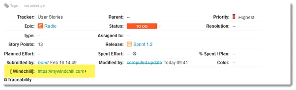

Now, all items in that tracker will show a field with that hyperlink:
Please note that I am no expert on Windchill integration and I am not sure if this action will harmonize well or conflict with the official integration guides. For more information, please consult Codebeamer DPT Integration.
