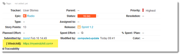

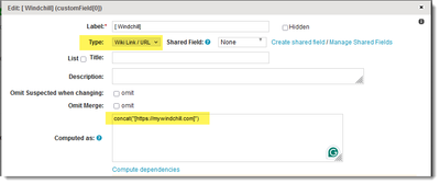

Hi @VM_10824513 , if you want a Codebeamer tracker field always to have a certain link by default, you can create a new custom field of Wiki Link / URL type at tracker configuration > Fields tab and add a computation formula like for example concat("[https://mywindchill.com]")
Now, all items in that tracker will show a field with that hyperlink:
