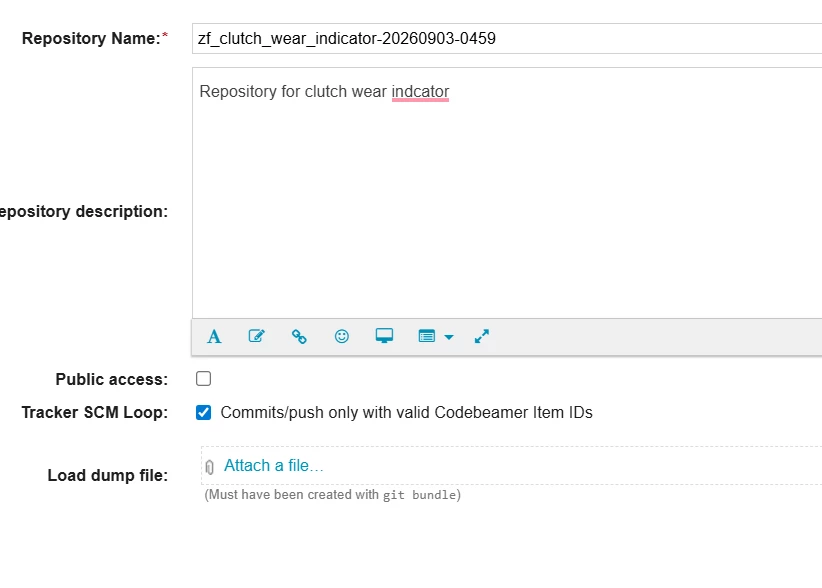

I try to create new git repository for my project. what is meant load dump file-git bundle?

A git bundle is a tool that is built into git that allows you to package up and repository into a single binary file. This allows you to migrate a repo from one location to another and retain the git history in the new repo. A use case would be moving a repo that was being managed via github into this new Codebeamer repo.
Here is the official git documentation on how to create a bundle if needed. https://git-scm.com/docs/git-bundle
