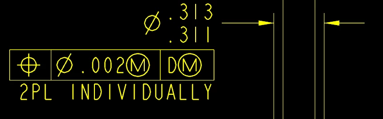

2X or 2PL INDIVIDUALLY?
Is there a difference in meaning when using 2X or 2PL INDIVIDUALLY?
thank you,
-Art

    Jan 17, 2012 3:02 AM UTC
    I believe both mean the same thing. 2X is more brief and typical than spelling it out.
    Jan 17, 2012 6:57 PM UTC
    Hi Art,
    There is a difference. See page 138 (Fig. 5-39) of ASME Y14.5M-1994 for the explanation. This notation is only used when the datum itself has its own note next to it saying 2X INDIVIDUALLY.
    Also the use of PL is dated - the symbol X is now specified.
