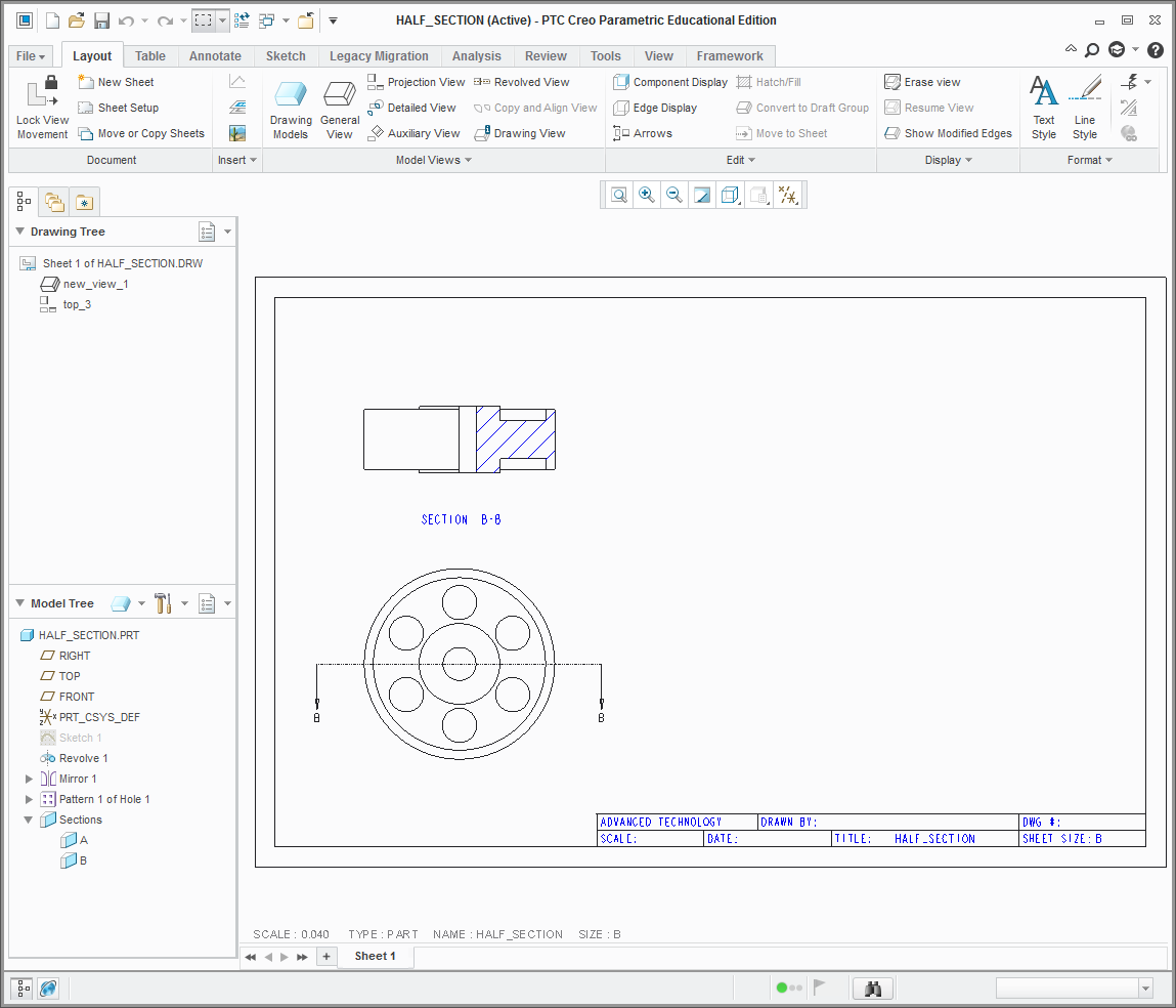

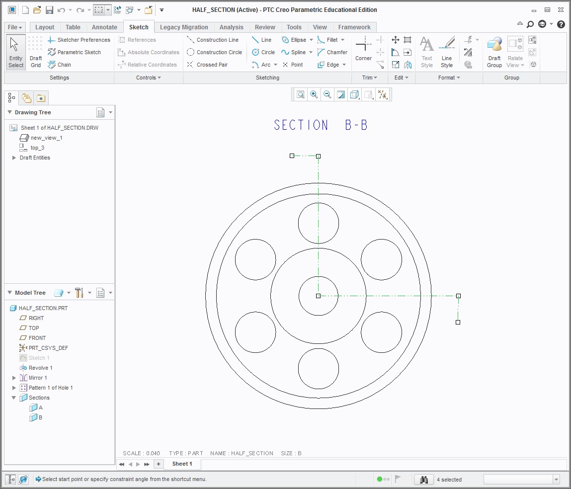

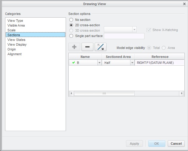

I have been able to create a half section by using the 2D cross-section>Half sectioned area but I can't seem to get a broken section line in the referance view. Will CREO not do this or am I missing something?
CREO parametric 3.0
Thanks for any help.

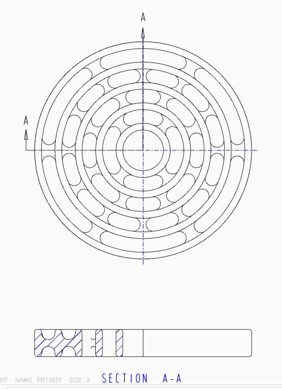

What I did.
The result.
What I am wanting.

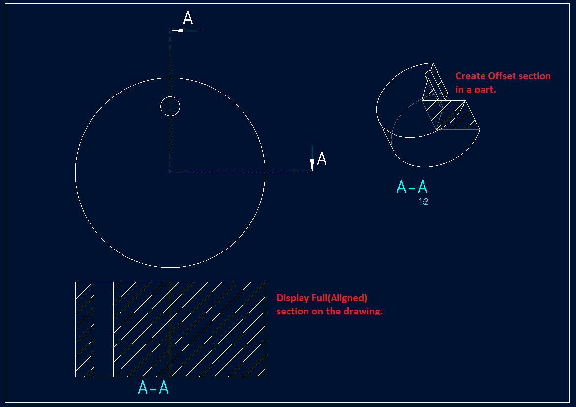

I think you want an offset cross-section and not a half section. You have to build the offset x-section in the model, ie sketch the cutting plane.
Oh, also, the side view is unfolded.

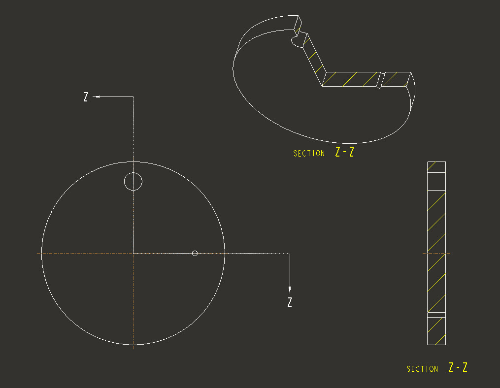

Andy,
I am not sure if I understood your question ...
What about this ?
Martin Hanak
Nov 4, 2014 8:47 AM UTC
I think the closest we can come to the standard is this:
StephenW
