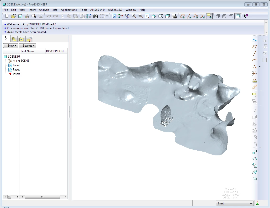

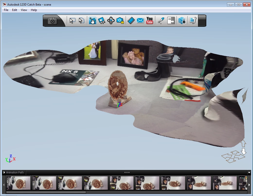

I just wanted to share this because I thought it was amazing! We took 30 pictures of a platewith an iPad running the appand a model was automatically created.
By opening the scene in the desktop version, I exported as an .OBJ file which could then be opened in ProE!

    Looks like you would still need to use another software to fit a NURB surface to the mesh (i.e: PolyWorks, etc.) before importing into Pro-E. Otherwise, you are only viewing the mesh file in Pro-E.

    I tried just using our lab digital camera and the desktop version but it was very difficult to connect all the points in the pictures by hand.
    There must be something magical about the iPad version because it just created the model by pushing a button.
    After bringing in the mesh file into pro-E you would need to use
    something like Pro-scantools to turn this into surfaces, and they could
    be very 'crinkly' I would guess that pro-scantools would then have some
    ability to smooth the result.
