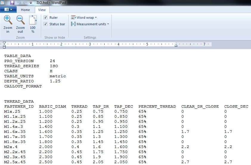

    Some of you submitted some .hol file examples and I greatly appreciate it. So how do I read it? I am not talking about how to open it because I used Word Pad just fine, but how do you actually read the file? I can't figure out what all the numbers relate too. Diameter, lenght, etc.
    The top section is fairly simple but the bottom section is like Matrix code. See below.
    TABLE_DATAPRO_VERSION 24THREAD_SERIES UNCCLASS 2BTABLE_UNITS inchDEPTH_RATIO 1.22CALLOUT_FORMAT &Screw_Size &Thread_Series-&Thread_Class <ctrl-a>x<ctrl-b> &Thread_Depth /<ctrl-a>w<ctrl-b> <ctrl-a>n<ctrl-b>&CSINK_DIAMETER[.2] X &CSINK_ANGLE[.0]<ctrl-a>$<ctrl-b>
    THREAD_DATAFASTENER_ID BASIC_DIAM THREAD TAP_DR TAP_DEC PERCENT_THREAD CLEAR_DR_CLOSE CLOSE_DEC CLEAR_DR_FREE FREE_DEC CLEAR_DR_MED MED_DEC CBOREDIAM CBOREDEPTH CSINKDIAM CSINKANGLE BOTCSINKDIAM BOTCSINKANGLE#1-64 0.073 64 #53 0.0595 81% #48 0.0760 #46 0.0810 0 0 0.1563 0.073 0.085 90 0.085 90#2-56 0.086 56 #50 0.0700 62% 3/32 0.094 #36 0.1070 0 0 0.1875 0.086 0.10 90 0.10 90#4-40 0.112 40 #43 0.0890 65% 1/8 0.125 #29 0.136 0 0 0.2188 0.112 0.12 90 0.12 90#6-32 0.138 36 #36 0.1065 71% #23 0.154 #18 0.170 0 0 0.2813 0.138 0.15 90 0.15 90#8-32 0.164 32 #29 0.1360 62% #15 0.180 #10 0.194 0 0 0.3125 0.164 0.17 90 0.17 90
    "Too many people walk around like Clark Kent, because they don't realize they can Fly like Superman"
    TomU
    Dec 13, 2012 9:00 PM UTC
    Turn off word wrap.
