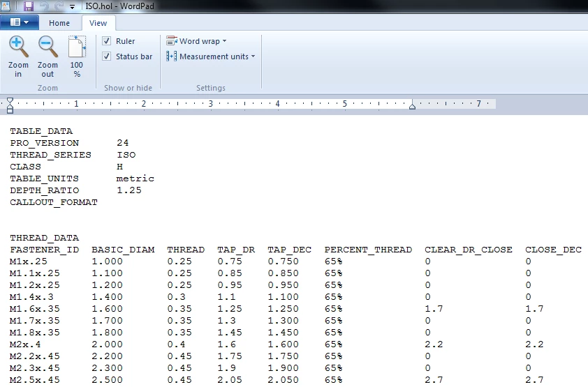

Is there a way to add additional standards for hole in Creo? We have UNC, UNF and ISO out of the box but we use many ACME standards.

    Search the knowledgebase for TPI 107248 - Customizing The Standard Hole File

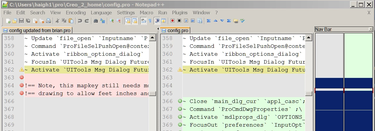

    Or use a real editor like notepad++

    I was told to turn off Word Wrap in Notepad. I feel like a total idiot for not doing this. ROFL
    Thanks for the correct answer and not calling me a moron in the process.

    To follow David’s recommendation, look into Notepad++ it is a great editor with a lot of useful features.
