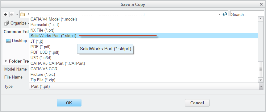

    Prabhu,
    If you are working with Creo 3.0 and have license Collaboration_Ext_SolidWorks, you can Save the data as Solidworks data (.sldprt or .sldasm)
    Check article at https://support.ptc.com/appserver/cs/view/solution.jsp?n=CS184567
    For earlier versions you may try using global translates .iges or .step

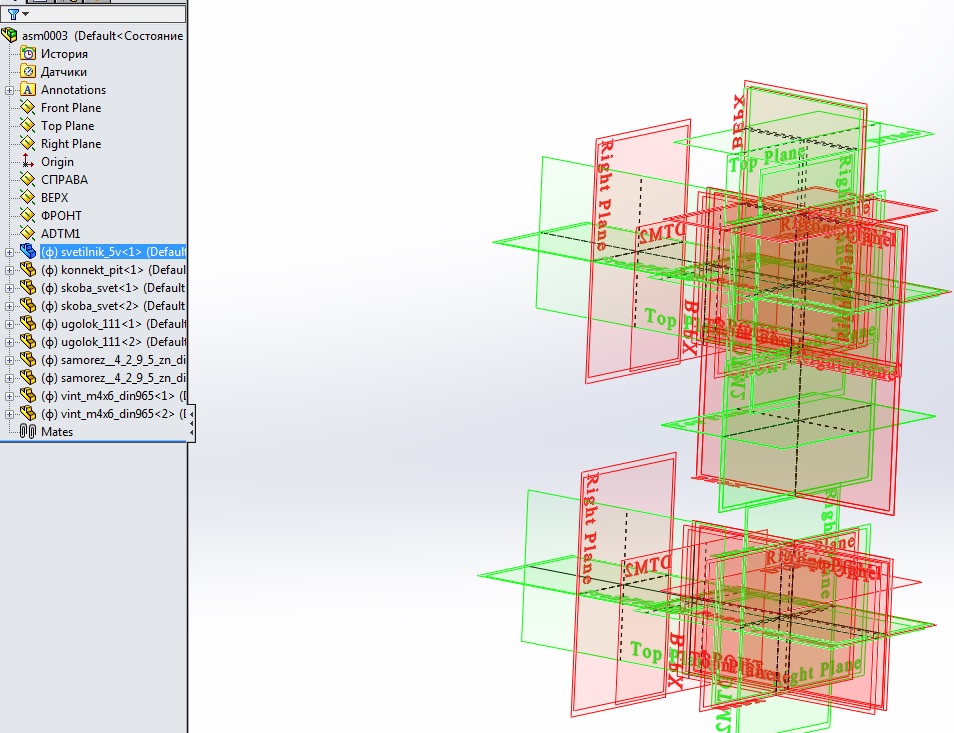

    Dec 25, 2016 11:02 AM UTC
    Good day!
    I am working with Creo 3.0 and have license Collaboration_Ext_SolidWorks.
    When I save my Assembly unit in CreO as Solidworks.sldasm, open this file in Solid Works, so I get unit without any solid geometry, but only basic planes, like in this picture. Please, help me, how can I translate my unite from Creo to Solid Works? Thanks in advance.
    StephenW
    Dec 27, 2016 1:13 PM UTC
    Hi Olimpiya,
    You should repost this as it's own question instead of a reply to an existing post. You will likely get much better help.
