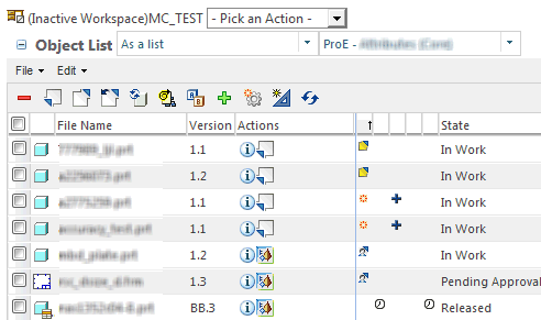

    Oct 27, 2014 8:25 PM UTC
    Tom,
    To answer your original question, all of the shown in the image below are
    OOTB (Out of the Box). What you need to do is create a CUSTOM view for your
    users.
    If you place you mouse over the icon it will tell you the meaning.
    Yellow box - checked out to me
    + - modified locally
    clock - out of date object
    person icon - object checked out by John Doe or whoever
