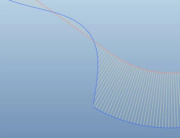

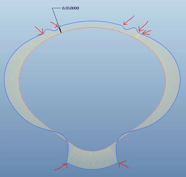

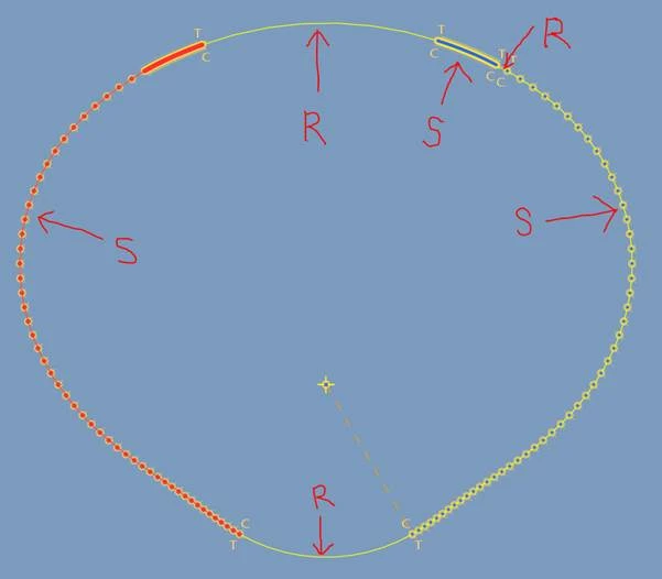

Can someone help me understand why the output from 'Analysis - Geometry - Curvature' doesn't look "smooth" (tangent). The geometry is constructed from 3 splines and 3 radii with curvature continuous attachments between them. Thanks.

    After more reading it appears that I was looking for "G3" or "C3" continuity, which Pro/e can't do.

    You're not using Pro-E's functionality whichproduces Curvature Continuous curves. I'm guessing you may have initially learned SolidWorks and you're expecting other CAD systems to be the same as you initially learned?

    Hi Tom,
    Not sure how you are creating the curves, are they all sketched? are they all part of the same sketch? are they on the same plane? After all that, you may find you get a nicer surfacing curve by copying the curve (or curve segments) and pastingas a curve, during the paste operation, change from exact to approximate.
    I use this technique when surfacing to generate better surfaces. The curve you are generating using this method is called an approximate composite curve.

    That would probably be a good method. Make sure that you watch for tangency issues from curve to curve.
