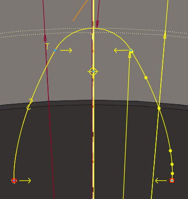

Extrude this, by Projecting it into a sketch, mirroring it, and adding a root fillet between the two flanks:

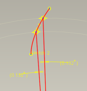

The involute equation includes an offset angle, which generates the clearance between the two parts by effectively rotating the offset about the origin.  If I measure the angle between the two curves at any diameter, I get a constant angle, as I expect:

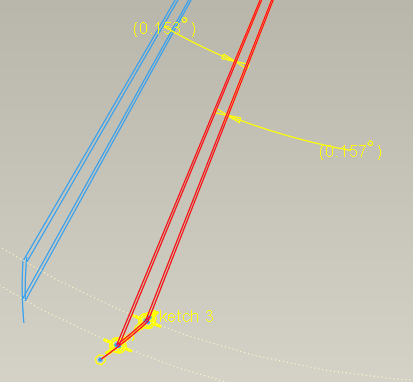

However, when I measure between the actual solid geometry (and this is what our analyst noticed when running FEA), the angle is not constant, and the OD is closer than the ID:

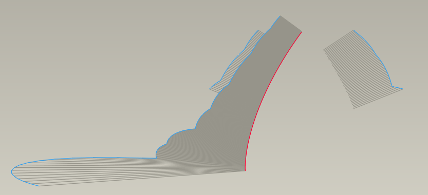

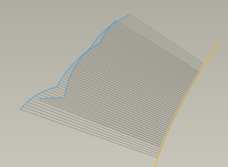

It appears to affect both flanks, regardless of whether it's the 'original' or mirrored side, so I don't think it's caused by the mirroring op.  A curvature analysis also suggests that the mirror is good, although it does show some worrying unevenness:

    Also, the curvature for the two parts doesn't seem to match:

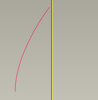

    In Creo 3 (M120), I compare an involute generated using the "curve from equation" (labelled with blue leader lines)
    to the same-sized involute generated by spline->from file sketching tool with the 90 points in the file calculated using the same formula but in an excel worksheet (light green)
    visually, the two involutes overlap  - but the curvature analysis reveals that there is something fishy about these curves from equations - their curvature graph should be smooth.
