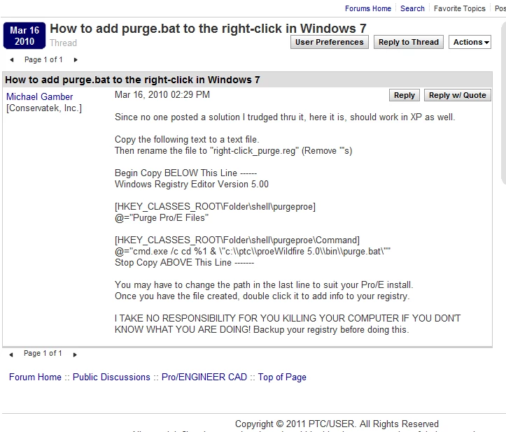

    Hey All:
    I know this has been asked before because I searched the archives and
    tried:, (see image below). It didn't work. What did I do wrong? Are
    the double \'s <file: \'s="> correct in the path name? I did change
    the path name to: C:\Program Files (x86)\proeWildfire 3.0\bin\.
    Thanks.
    Wildfire 3
