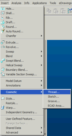

    CAN SOMEONE EXPLAIN HOW PROE DOES AN EXTERNAL THD ON A PART. FOR INTERNAL YOU DO A SIMPLEHOLE AND CHANGE IT TO A THD.
    HOW NICE. HOW ABOUT A NICE SIMPLE EXTERNAL THD.

    May 7, 2012 1:49 PM UTC
    Lawrence,
    Looks like the image somehow got stripped from your email.
    Here it is.

    May 8, 2012 12:41 PM UTC
    Sorry for not posting.
    The results were 2
    1. Cosmetic , thread - if for looks only
    2. Insert, helical sweep- if being used to machine or grow
    Thanx all for the help
    May 8, 2012 8:01 PM UTC
    I would think that for most, if not all instances, CAD, FEA, CAM using a
    helical sweep profile would be a detriment. I know that modeling
    springs, bolts, etc... using helical features really bogs the regen
    times down.
    Stick with cosmetic.
    Now, PTC needs to include some intelligence to the 'hole' type to help
    the CAD/CAM system deal with interferences, and recognizing tapping
    sequences as you should model the part in a 'stock safe' condition. OD
    threads at the OD and holes at the tap drill dia.
