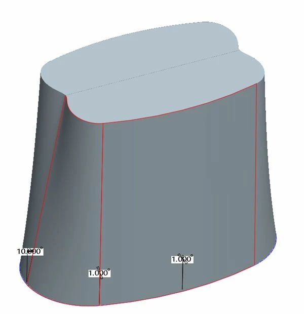

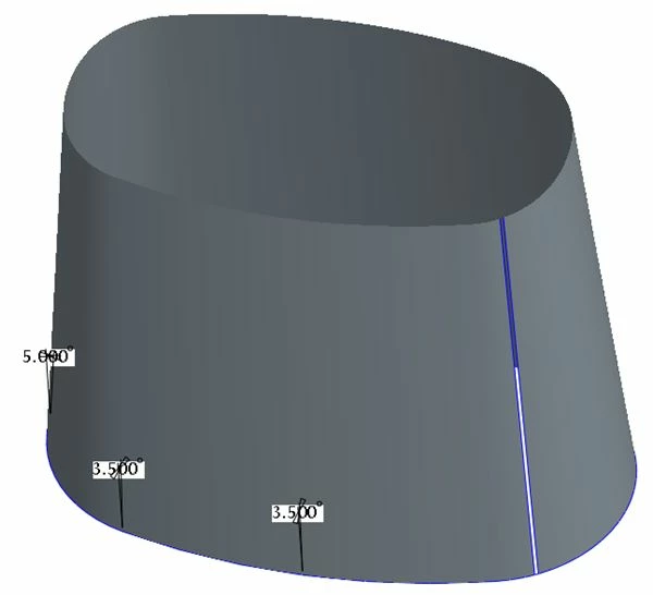

I am trying to flatten a quilt. I have used the "Flatten Quilt" tool
before. It sure is a great tool when it works in "auto" mode.
I think my problem today comes from the fact that the quilt is an extrude
with a variable draft:
Any hints on how to get this to unwrap?

    Are you sure the geometry will flatten? Thinking about this and looking
    at your picture, I don't think so. The variable draft angle makes it
    'twist' in a way that's no longer a single ruled surface, and therefore
    not flatenable (is that a word?).

    nrollins2-ExplorerAuthor
    2-Explorer
    September 21, 2007
    Well, At least I can be assured that I have the world's best minds on it.
    Doug, I actually have your very nice explanation on VSS terminology from
    just yesterday in my box to review when I get a chance. Today might be the
    day. Thanks a lot for that, too!
    I really like Karl's vision of rolling the thing on the floor, but I fear
    that it may rock slightly along the extrude's axis, as well as roll along
    over the drafts. As is my custom when trying to trouble shoot things, I
    like to go to the extreme. This is what happens when you change the
    transition to 10 x 1 degree:
    I think it is NOT a single ruled surface. Pro/e wouldn't lie...
    This even shows that the bottom surface becomes nontangent.
    This sucks more than I thought it did.
    Thanks again for all your help.
    -Nate

    The solution is in fact possible, but not using draft. I had a couple of
    people try to flatten my variable drafted version without success. If the
    sides need to be "single ruled surfaces" then they need to be constructed as
    such using a VSS. Variable draft is a great tool, but I guess the
    mathematics it uses do not consider such a constraint. A simple sweep of a
    straight line using the top rim as the origin and the bottom foot perim. as
    the x-direction gave me exactly what I needed.
