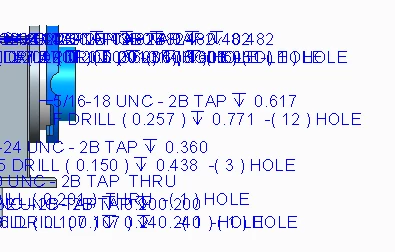

I updated my system to m080 late last week, this morning I notice this.
[cid:image001.png@01CEE9C6.A972EA00]
It wasn't like this in m070.
How do I turn this off?

    The screen shot is from assembly mode.

    Nov 25, 2013 7:22 PM UTC
    [cid:image002.png@01CEE9D9.066D1430]
    Once in Creo, click the annotation display circled in red. I'm sure there is a config that will default this to off.

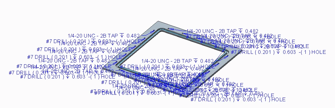

    Here's a part mode screen shot.

    There was a change where the Creo was looking for configs between two build codes of CP2. I'm guessing your company config in the install hid these by default.

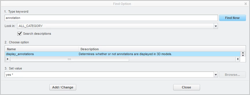

    The config option is
    [cid:image001.png@01CEE9C8.C44D14C0]
    David Haigh
    davehaigh13-AquamarineAuthor
    Nov 25, 2013 8:00 PM UTC
    So I tested this in m070 and m080 without the config option in either version.
    * M070 the hole notes don't display in part and assy mode
    * M080 the hole notes do display.
    The only fix is to add the config option to m080 and set it to no.

    So I heard back from PTC on this. This is actually a fix of behavior that wasn't to spec before.
