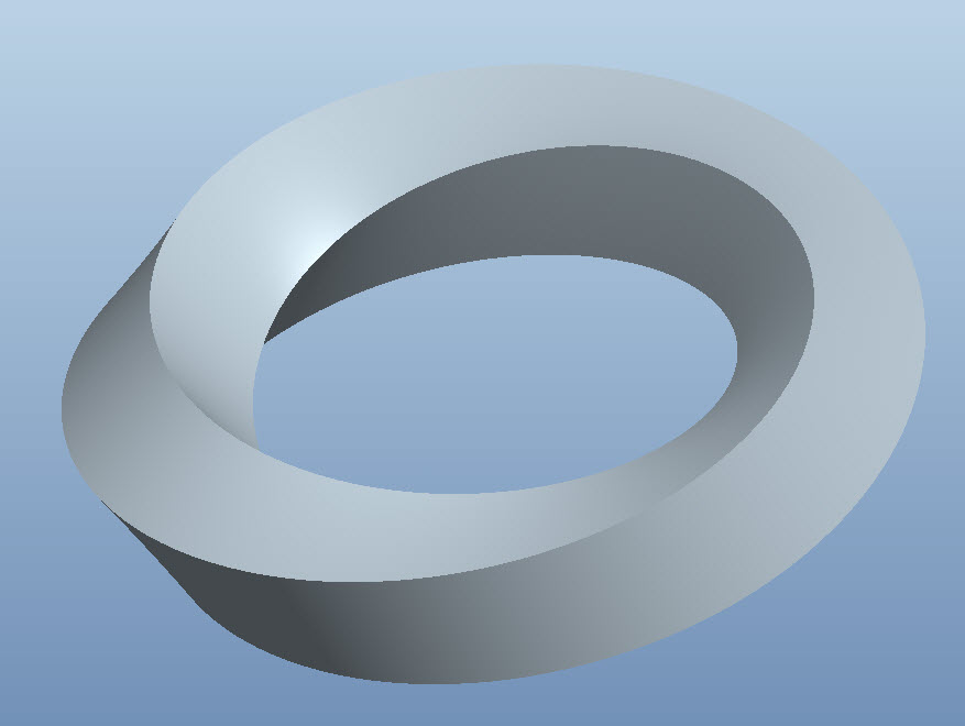

I'm really struggling with this issue. Does anyone know how to create a nice, visually pleasing möbius strip in Creo Schools addition? Here is what I really want the model to look like: http://sketchup.google.com/3dwarehouse/details?mid=316a27ba42a11a71abdffc6614cbf81a&prevstart=0 (the model is done in skechup, free from Google, if you are wondering about how to open .skp.

    Off hand, I think you could do it with a swept blend on a circular trajectory. Just start and end with a square and move the start point to create the 'twist'.
    * You may have to do it in two semicircular sections.

    Variable section sweep would be what I'd use. It would make sure the strip length would remain constant, something that would be tough to do with a swept blend.

    In case Lucas needs a bit more info:
    • Make a variable section sweep using a circle as the trajectory.
    • Use a rectangle as the shape of the section (or someting more creative after you try this).
      • Allow there to be an angular dimension that will allow the rectangle to rotate.
      • The section should only be constrained to itself. Meaning no dimensions to an axis line (other than the angular dimension) or perpendicular constraints to the axis lines, etc.
    • While inside sketcher, create a relation (Tools>Relations) such as sd16=360*trajpar*1. Substitute sd16 with your angular dimension's alias. The 1 after trajpar can be increased to add rotations.
    I hope this works for you, let us know.
    -Kevin

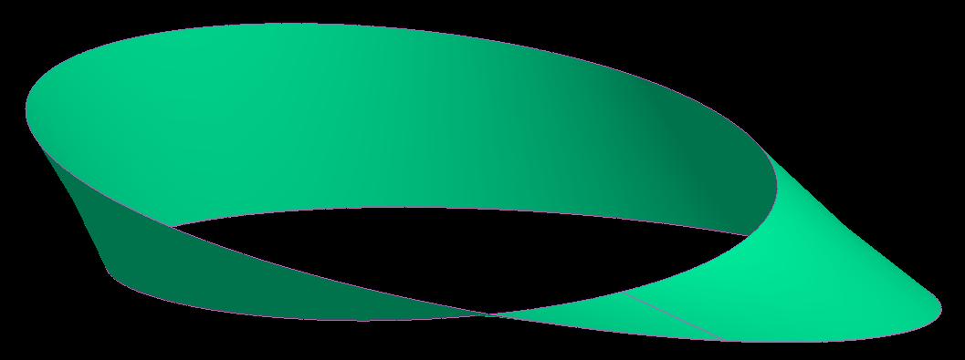

    Why a rectangle? A mobius "strip" is just that, a surface. Also, only odd increments of 1/2 turns (180deg) make a Mobius Strip (i.e.: 180deg, 540deg, etc.).

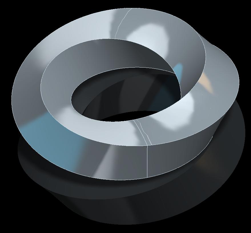

    This was done using two swept blends, though I think Frank's solution is probably more elegant.
    http://dl.dropbox.com/u/11404499/prt0001.prt.2
    Good luck!

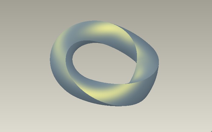

    Buddy, it looks to me like there's a full 360deg rotation there. If so, it's not actually a Mobius. I true Mobius only does a half twist per revolution, or odd increments of half twists. Can you attach a STEP file please?
    Feb 8, 2012 12:10 PM UTC
    Why didn't you upload the PRT.
    my english is poor ,i cannot explain clear what is my mean.
    this is my prt .(creo 1.0)
