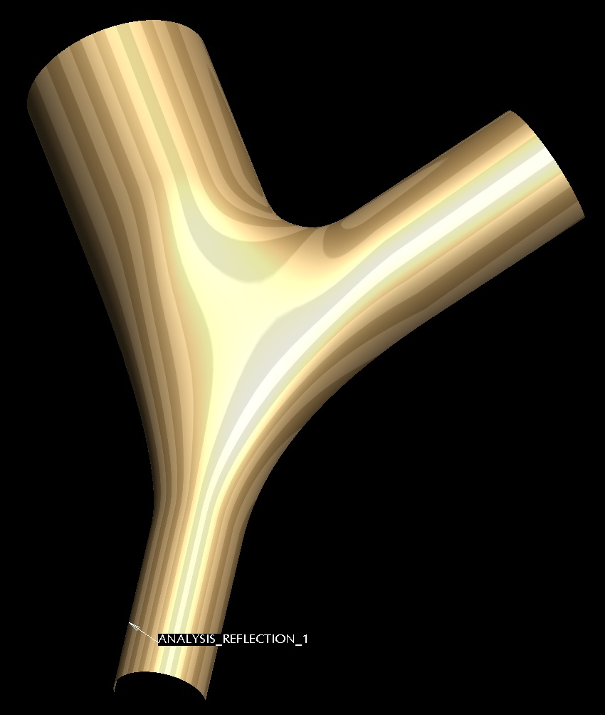

I did an N-Sided patch and think it turned out pretty well. Haven't done one of those in forever. Don't have the "Style" extension.

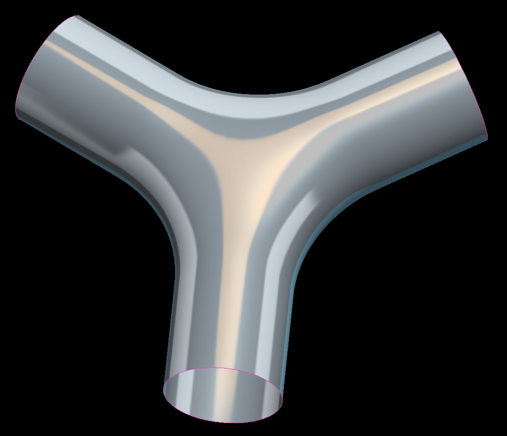

Okay; 3 days and many fails... I finally got one that might pass mustard. (don't ask me who came up with that one!)
All surface boundary blends were joined using curvature.
If I had to explain the process, I couldn't. ...So I attached the file.
But it also passed the final test. It solidifies!
Creo 2.0 attached and STEP.
Set shade quality to about 10 to see get a fairly smooth surface to evaluate.

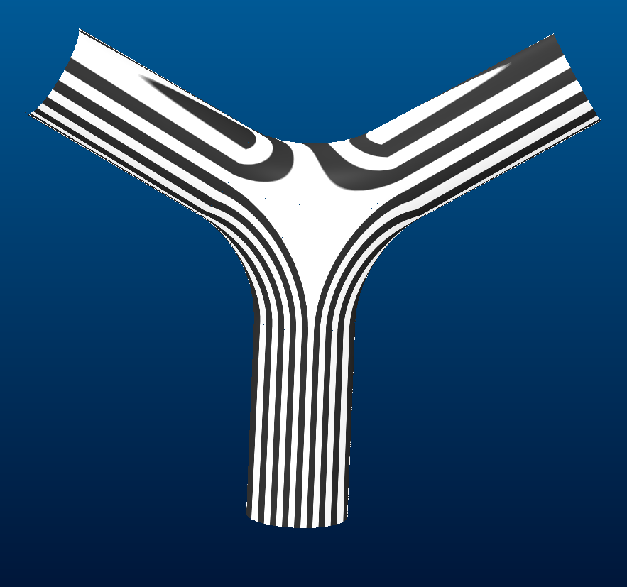

Ok, for fun...
3 different sizes, 3 different angles, and I can vary the shape by changing the rho numbers. I'm really liking the n-sided patch. Too bad it can only be used on 5-sided+ patches. The reflection analysis came out pretty good, I think. The GUI on setting up the tangencies is a total PITA......
Sep 5, 2014 9:10 PM UTC
For ID and analysis, you really cannot use tangency... and with curvature, a lot of features simply fail.
Vladimir's video clears up one thing where I used the cutout to fill the triangle, the projected tangent curve would solve by giving it a more natural shape.
This really should be dead simple to create with full high order unions. Click, Click, Click and tweak some handles. The idea that one can be creative on an idustrial design level with Creo Parametric is a cruel joke. Just when you get an idea, you are bogged down in 2 days of feature failures for just a single element!
