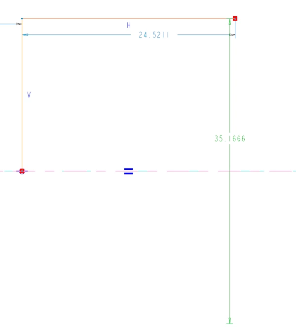

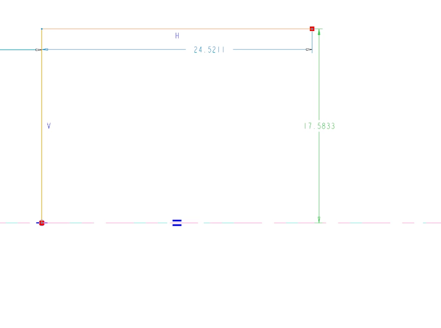

Does anybody know what command is responsible for converting radial dimensions to diameter dimensions when one works in a sketch mode within a model? Refer to the attached images.

    I work in Creo 2.0.  Note that I've configured my system such that sketches start out without any "pre-selected" references.
    So when creating the sketch that defines the section in a revolve feature, first thing I do is defines the axis of revolution.  I do this by right clicking in the empty graphics area and choosing "Axis of Revolution".  After I draw this special axis, then when I sketch my geometry lines that define the section, Creo automatically puts in (weak) diametral dimensions.
    If I try to do it backwards and first draw the section and then designate the axis of revolution centerline, I do not get an "automatic" conversion from radial to diametral dimensions.
    So to answer  your original question, there is no setting that will "convert" radius dimensions to diameter dimensions, but there is a workflow where the diameter dimensions will be automatically created.

    Let me be more precise. Here is the link to the video: Видеоурок Creo Parametric 3.0 Моделирование цапфы. - YouTube . The issue that I concerned with is raised at 1:18. Take a closer look - the diameter dimension appears automatically instead of the radial dimension.

    Dec 7, 2016 3:32 PM UTC
    Have you tried setting this config.pro option?
    sketcher_dim_of_revolve_axis yes

    Dec 8, 2016 2:16 PM UTC
    The dimension you show looks like it may be a strong or locked, if so it won't change when you a geometry centerline. It only works with weak dimensions.
    Dec 8, 2016 3:46 AM UTC
    The centerline which acts as a central axis for revolve is the real cause of the diameter dimension. If the centerline is removed the dimension automatically taken from the reference.

    Dear All,
    Thank you very much for all your answers. Although I`ve already chosen the right answer, I will highlight the main stages in creating diameter dimensions:
    1. Set sketcher_dim_of_revolve_axis yes in config.pro;
    2. Create a new model;
    3. Choose `Revolve` in the model Ribbon (it will help Creo to understand that you are going to create a solid revolution)
    4. Draw `Axis of revolution`;
    5. Draw the intended profile;
    6. Click `Ok`.
