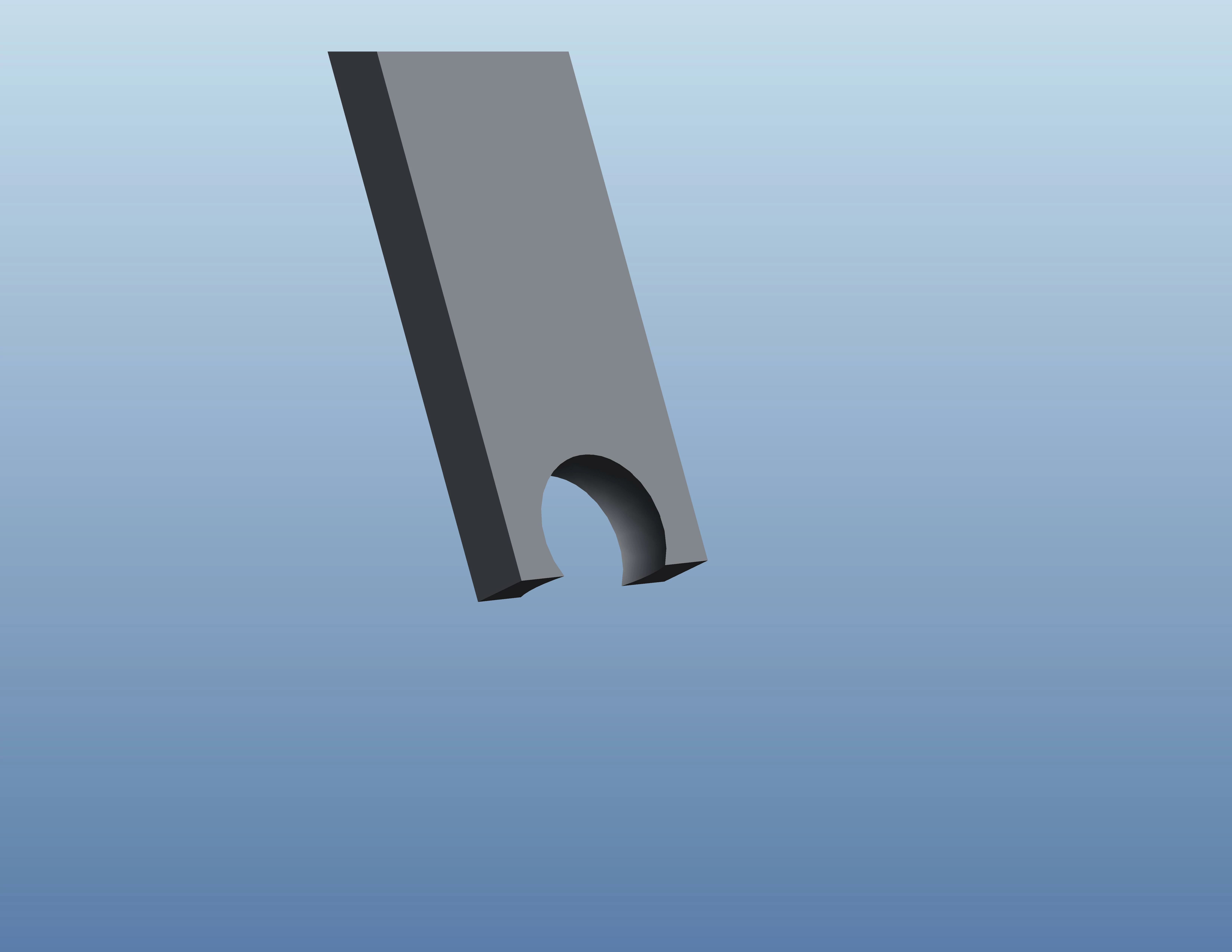

How to create a ball joint
This may be a little difficult to explain but I have two arms that I want to connect with a ball joint. The movement will be up and down, and also swivel 360 degrees. In the first arm I have a spherical cutout where I want to attach the ball, it will be inside that cutout that the ball will move and swivel. How do I or can I constrain a ball inside that cutout to get that sort of movement? I know there is a ball constrain, but I'm not sure how to use it. attached is a picture of the cutout where the ball will be inserted.

    Aug 10, 2010 3:29 PM UTC
    Basically I've controlled the position of Ball Joints using Datum Points. I attach one point on the external of the ball and attach one point on the internal of the cutout. Then I align the points at the assembly and change the position by changing the location of the point internally to the cutout.
    The attachement is in WF5 as my example.
    Aug 10, 2010 4:08 PM UTC
    That makes sense, however it doesn't give you the ability to use the drag function to allow easy maneuverability. Thanks for sending that to me, If I can't find out how to do it the way I'm thinking it should work I'll use your method.

    Christian,
    If I understand correctly, you should be able to accomplish the task by using a "ball" constraint and a "planar" constraint.
    I've attached a sample for clarity.
