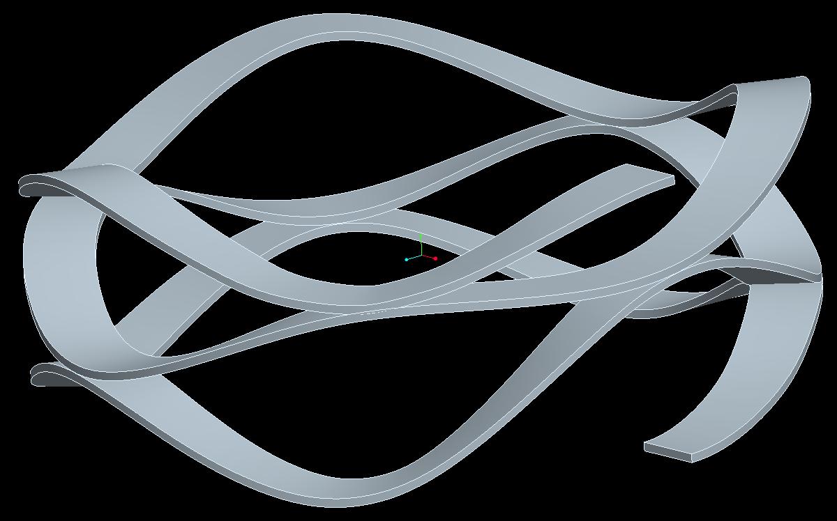

    You mean something like this?
    Note the reversal.

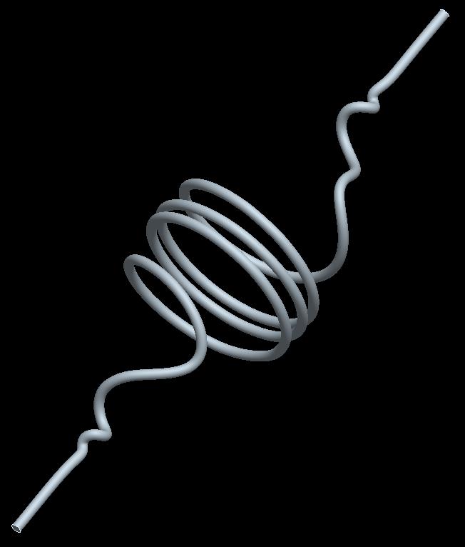

    August 19, 2010
    This maybe?

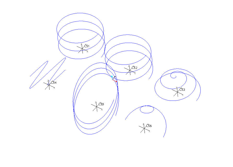

    Blue,
    A little more general answer: The Curve-By-Equation technique involves the use of so-called parametric equations. (You may have had a one-day introduction and assignment dealing with them in a high school trigonometry or analytical geometry class.) The equations all depend on just one parameter which takes on all of a finite range of values to determine the simultaneous results for the dependent equations. In this case, the parameter you use must be t and it will take on the continuous values of 0 to 1. (The same idea is used in Variable Section Sweeps where you use trajpar, as opposed to t. Both of these techniques couldn't be more appropriate for parametric software.)
    As an example, if you write the equation x=y you would create a 45 degree "climbing" straight line going to infinity in both directions. If, on the other hand--using the parametric technique, you write the simultaneous equations x=t and y=t you create a 45 degree line from {0,0} to {1,1} only. These equations never go to infinity because the independent variable stops when it "gets to" 1.
    Obviously, you wouldn't use this method for something that simple. On the other hand, if you want to create some kind of interesting variable spiral or the involute for a gear tooth this technique is great. Choose your type of equations carefully. For example, if you are creating some kind of helical curve you can certainly do it with Cartesian coordinates employing sine and cosine functions for two of the 3 equations (usually x & y), but it's much easier to use Cylindrical coordinates and just type in a straightforward function for theta. As a further clarification, if you wrote theta=4*t*360, you would generate 4 complete turns in your helical geometry. (You need to multiply t--0 to 1 only--by 360 to get one complete turn).
    Hope this helps!
    David
    August 23, 2010
    For example:
    CS1--Cartesian:
    x=2*cos(3*t*360)
    y=2*sin(3*t*360)
    z=3*t
    CS2--Cylindrical:
    r=2
    theta=3*t*360
    z=3*t
    CS3--Spherical:
    rho=2
    theta=90-(2*t*45)
    phi=3*t*360
    CS4--Cartesian:
    x=4*t-2
    y=2*sin(2*t*360)
    z=3*t
    CS5--Cylindrical:
    r=2
    theta=3*t*360
    z=2*(t+sin(3*t*360))
    CS6--Spherical:
    rho=2
    theta=90-(t*180)
    phi=t*360
