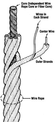

HOW TO CREATE MODEL OF WIRE ROPE
I WANT TO DESIGNE A MODEL OF WIRE ROPE WITH A SPECIFIC DIAMENTION PLEAS HELP ME FOR THISwire+rope.jpg111.JPG

    You really want to be conscious about your geometry. Do your homework on the actual geometry before you begin making the part. You have to know how to use curves and joint them to make the sweeps if you are after the diagram in your original post.

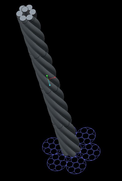

    May 5, 2014 11:33 AM UTC
    May 5, 2014 4:52 PM UTC
    kind of neat, but I don't have time to continue at the moment.
    May 5, 2014 5:08 PM UTC
    Remember to use "normal to trajectory" on those wires to keep them "round".

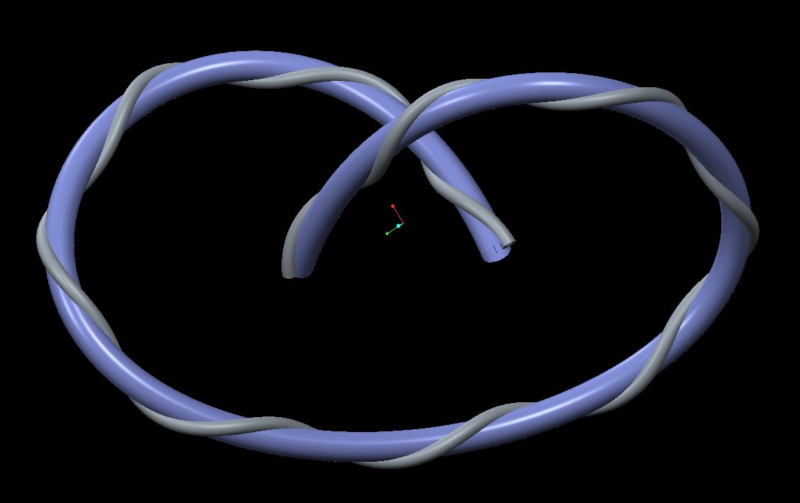

    May 8, 2014 9:37 PM UTC
    Now tie that rope in a knot.....
    May 18, 2014 11:23 PM UTC
    it starts slowing down the computer really quickly.
