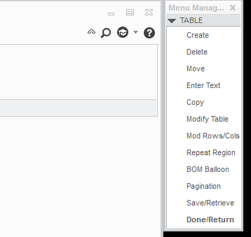

    You're not going to believe this, but the menu manager is still available!!!  To access it, create a mapkey with the #TABLE command:
    mapkey table #TABLE;
    I've just confirmed that applying justification to the table is kept when new rows or columns are added.
    I have not been able to find the commands that control text size or font.
