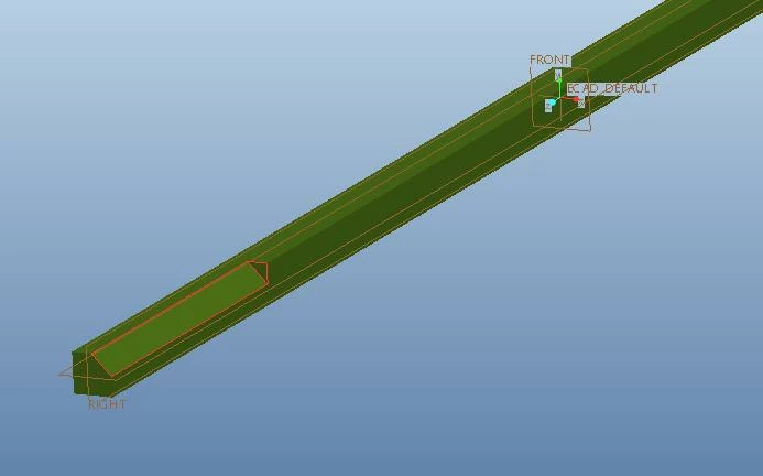

Let's say I have a 1/4" plate 12" long. On the 12" edge I want a 1/8" x 1/8" chamfer 2" long.
I can't seem to do this. I can make the entire length chamfered, but not a specific length.
What am I missing?

    You need to specify the end conditions of the chamfer.
    Before your chamfer, put datum points where you want the chamfer to start and end. While editing the chamfer, notice that in the toolbar there are two blue buttons on the far left. The first one is selected currently. Select the other one, called Transition Mode. Notice that the ends of your chamfer a highlighted. Click the end you want to change. Choose "stop at reference" then choose the datum point on that side. Repeat with the other side. This also works with rounds.

    Not missing anything. The chanfer is applied to the edge, so it goes down the whole length.
    Workaround: Create a sketch of your chamfer on the end of the bar and extrude-subtract for a length of 2 inches.

    May 9, 2015 12:05 PM UTC
    Dear Herb!
    You should go extrude from which face you need, then use option of " Remove Material". Find the attachment, it may be helpful for you.
    May 11, 2015 3:56 PM UTC
    It would be nice if it included a rounded out section at each end. I.e. if you were going to mill this feature with a chamfer tool, you can't make it as drawn. You need entry and exit. I've used a sweep to create these in the past so that they look like what the final part would. Kind of a pain for something so simple.
