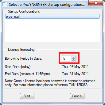

    Hello Michael
    It is not possible set licence borrowing for 14 days.
    Default licence borrowing period is set for max. 5 days:
    Note: you can use USB Net Adapter for your licence (will be used as a license key)
    Vladimir
    May 26, 2011 5:51 AM UTC
    Hello Vladimir,
    that's the normal setting. When you set environment variable "LM_BORROW_DURATION=0-14" you can set borrow-length up to 14 days. See Administration and Installationguide page A-14

    Hello Michael
    Yes I know about this option - so I wrote that the default Settings is 5 days .
    A few years ago was the setting for a maximum of 9 days, then extended it to 14.
    If you need to borrow a license for a longer period (more then 14 days), I recommend to you use of USB Net Adapter

    Pease find enclosed the reply from PTC regarding this issue:
    "Hi Frieder,
    Customer Feedback: This is a serious limitation for CAD-users working usually in a pool of floating licenses but need to go for an installation with a laptop for more than two weeks. Please describe how to use a license longer when been absent longer than 14 days.
    Article #: CS34737
    Thank you for taking the time to submit your feedback on this article.
    We at PTC Technical Support have reviewed the feedback that was submitted for Knowledge Base Article CS34737.
    At this time, our product does not support extending the license borrow beyond 14 days as it is a limitation from licensing tool (Flexera). We encourage you to Request this feature on the Product Ideas Page http://communities.ptc.com/index.jspa and/ or Vote on it if the idea already exists. This will help Product Management prioritize the feature effectively."
