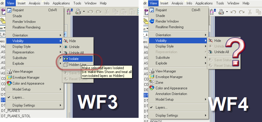

What happened with Layer Isolate in WF4, see screenshot attached? Is there an option to make it available again?

    Hi Hugo,
    This bothered me too. I asked Glenn Beer who did a presentation on Layers at Tampa (2007) where he promoted the use of Isolate. He thought it was there but then came back with this reply...
    "Oh! Yes! You can drag the isolate icon from the customize dialog into the text menu View>Visibilities. Where it becomes a new line item there."
    Why it is visible in the custom dialogue box and not in the menu in the first place I have no idea. Makes me a little worried that some folks at PTC do not really understand what Isolate does so do not worry about having it available (we thought we had lost it with the move to WF). I would like it on my RMB along with Hide and Show for layers. In the end I have also put the icon for Isolate in with all the other Layer Icons in my config.win. After suggestions from Glenn I have all my visibility Icons (datums etc, Layers, Views, View Manager) in a toolbar on the far left of my screen to the left of the model tree. His rationale is that this means the icons are always in the same location and I like this.

    PTC took it off the stock UI. You need to customize a tool bar to include
    the Isolate icon. It looks like an eye inside a dashed box. BTW It may not
    grouped with the other display status icons of hidden and unhidden.
