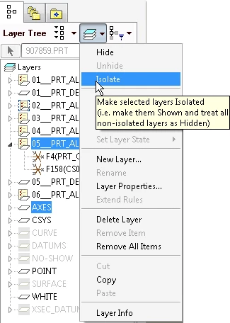

What happened with Layer Isolate in WF4, see screenshot attached? Is there an option to make it available again?

    I wanted to shed some light on the decision to move (not get rid of) the
    isolate command in Wildfire 4.0.
    We've seen a trend by our customers to run with the layer tree undocked,
    and when doing so mousing between the layer tree and the layer commands
    in the view menu become excessive. Additionally, we sought to
    consolidate some of the later control and accessibility menus. In
    Wildfire 4.0, the layer commands (including Isolate) are now accessible
    in the layer tree in the "Layer" menu (the screenshot is WF 5.0, the
    word is replaced with an icon) as seen below.
    Additionally, the command (as mentioned in an earlier post) is still
    accessible for inclusion in toolbars for customization.

    Hi John,
    Thanks for explaining where the cheese was moved to.
    When I looked in the menu mapper from WF2 to WF3 and WF3 to WF4 the visibilities menu was greyed out indication no changes. I only found the icon in the customise screen after discussing with Glenn Beer.
    What I would really like to see is that the RMB menu comes up with exactly the same menu as the LAYER drop down menu you mention. For some reason the Isolate command is missing from the RMB menu. I suspect that other users of the Isolate command would like to see this too.

    John,
    I have not used the Isolate function in years. This thread got me
    looking into it again. Perhaps I know why I dropped its use (we are on
    WF3 / M170):
    In Part mode -- Isolate works as advertised EXCEPT: Items that have
    been selected and hidden manually (on the "Hidden Items" layer) always
    stay hidden, even if a layer that contains them is Isolated. The
    "Hidden Items" layer cannot be isolated.
    In Assembly and Manufacturing modes - I would expect Isolate to be a
    fast method to "de-clutter" the display and show only the layered items
    we are interested in. HOWEVER:
    Isolating a layer (or sub-layer) only impacts the display of datums in
    the component that contains the layer. All other components continue to
    display "clutter" as per their hide/unhide status.
    To "de-clutter" the display, we still have to select all other
    components and Hide their features.
    In Manufacturing mode - Behavior is the same as Assembly mode.
    ADDITIONALLY: The layer tree icons don't refresh properly when using
    "reset status". You have to force it to refresh by manipulating the
    layer tree.
