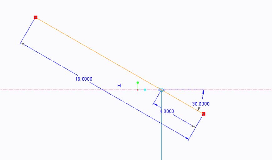

not able to give zero angle in sketcher to the line?
    9 replies
    2-Explorer
    Jun 10, 2016 3:25 AM UTC
    That is true. I'd bet it's because the solver can't tell when the angle changes which way is positive.
    If a zero angle is required, I create a datum on the fly that has an angle and align geometry to that. It is tricky to make sure that a horizontal line doesn't get excess constraints. Watch for parallel/coincident-horizontal constraints being added by Intent Manager.

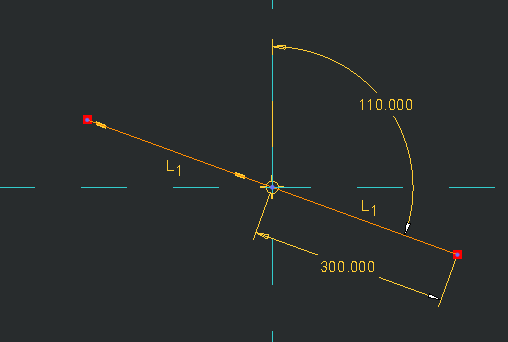

    in CR2 M070 I can set zero angle in Part mode. When I edit feature definition later, then Sketcher accepts zero value, too.
    MH
    Jun 10, 2016 5:52 AM UTC
    mine is student edition creo 2.0 m120.

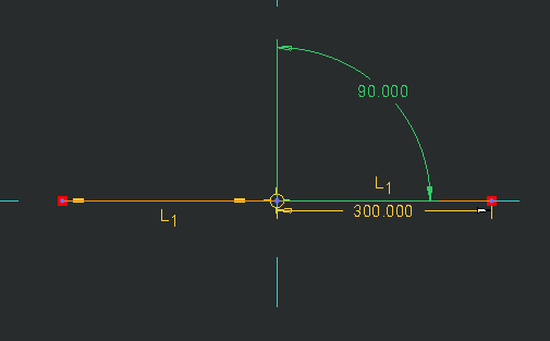

    Jun 10, 2016 6:03 AM UTC
    you can give angle in another way
    Change to 90 deg..
    Jun 10, 2016 12:42 PM UTC
    Once you have completed your sketch try Edit instead of Edit Definition. For me trying to change the value in sketcher wouldn't change it but it would using Edit.
