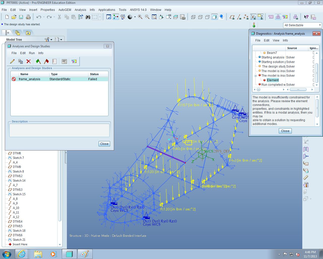

Not Constrained Correctly?
Does anyone know how to fix this problem?
    Nov 7, 2013 11:16 PM UTC
    You have no constraint in the z direction. See how all of your constraints show no filled in box in the upper right? The top row is translation; x, y & z while the bottom row is rotation. Fixed translations and other rotation constraints can resolve rotation issues, but only a constraint on a translation can prevent the model from translating in that direction.

    Nov 8, 2013 2:26 AM UTC
    It works now!!! Thanks for your help, I forgot to change my constraints.
    Nov 8, 2013 1:42 AM UTC
    It also appears from the picture that the highlighted beam might be disconnected from the other beams. You should be attaching to end points of other beams, and the picture looks like you might be trying to attach along the midspan of those side beams, which would leave the highlighted beam disconnected from the rest of the structure.
