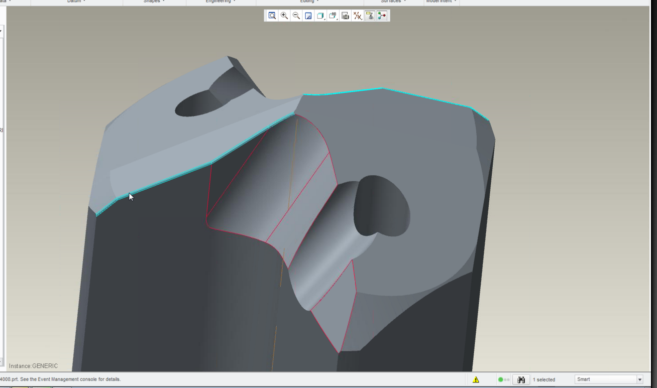

I have a customer asking if Creo can be used to optimize drill bit geometry. What combination of angles for the different edges will give the best performace for a certain material. Attached is an image of his model.

    It can be used to MODEL the optimal drill bit geometry, I can;t say it will just automatically DO it. You could create a family table of drill bits, using different geometries for different materials to be cut.

    Thanks Frank, I have research this a bit since my posting .. it is fascinating. I still have no auotimated solution, most seem to be OK with trial and error. I'm from the Mathcad side of PTC and if we had the math models we would optimize, but this is simply geometry, lines and angles, no functions involved.
    The search continues. If I find anything I wil post

    It's not simply geometry, but a study in how to induce failure in various materials without damaging the tool and without catastrophic failure in the workpiece.
    Think of it as understanding the theory of failure of everything subjected to local forces.
